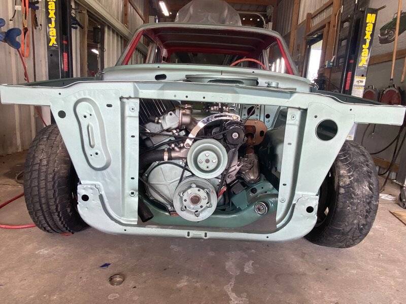

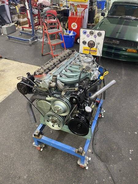

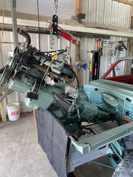

First off, ran the little Slant for about 5 minutes and sounded good, didn't want to get it blazingly hot.
with the combination of my overhead crane and Maxjax lift and Gary's help, the engine went in with just a little fuss (a minor scratch on the firewall, darned wiper motor bump!). Once in, worked the maxjax and crane together to get the dart up high enough to secure the transmission crossmember. for some reason I'm a little stressed by the operation, but I'm pleased! I hope the air cleaner clears the hood! This time also I have the correct motor mounts which set the whole shebang level.
I'm going to kick back for a few minutes then come back
:lol:

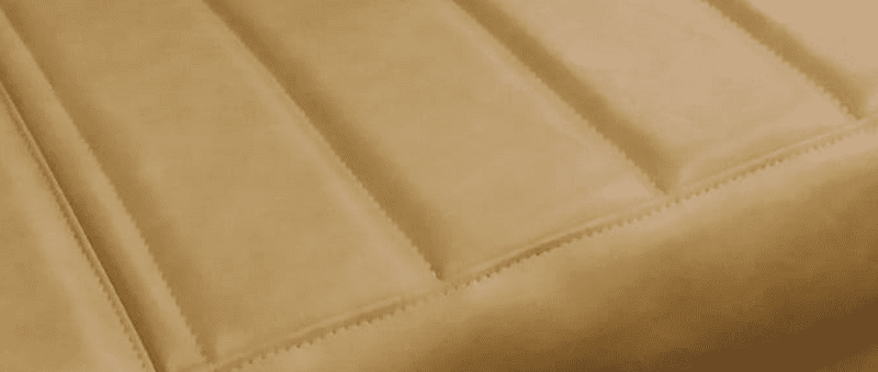

I have Seat Sewing experience, so that helps to know how they are put together and fabric selection to coordinate that all together for the desired outcome.
I sewed up a new set of seat covers up in MN just before I came down to FL this Winter season for the truck here, had patterns I took off the original seat to work from.
Brought the Consew sewing machine down with me to do the final fitting of the Boxing around the bottom. It is close now, but want it to fit right. A good fit is 90% of making the upholstery job look good.
