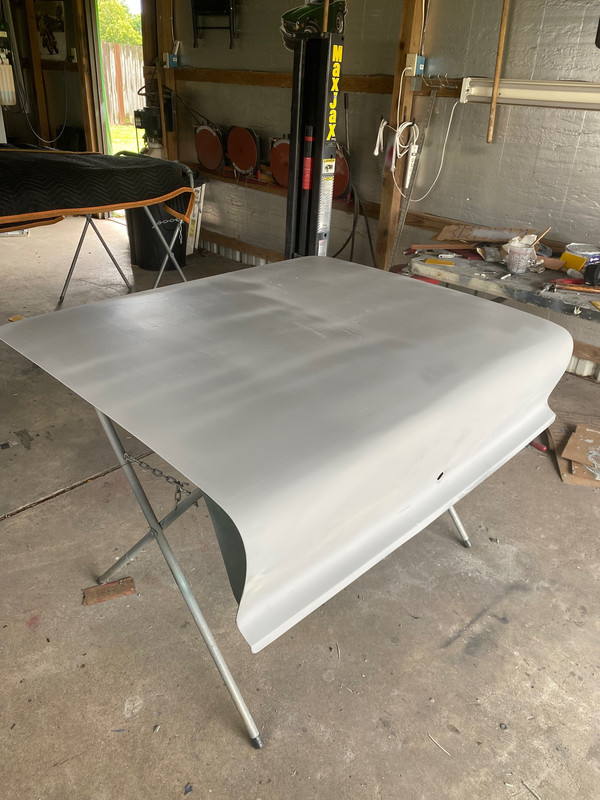

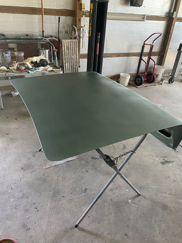

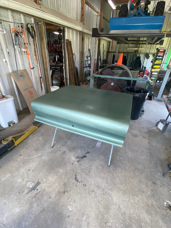

Must have had a baby cool front come through, so saw opportunity to finish the decklid;) Anyway, I put some work into this deck lid as most you know, not perfect, but will get the job done until I can locate another lid, but this should hold up for a while. I'll install tomorrow with the help of Gary and my brother Robo;)
