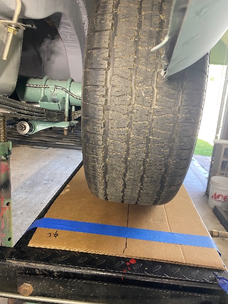

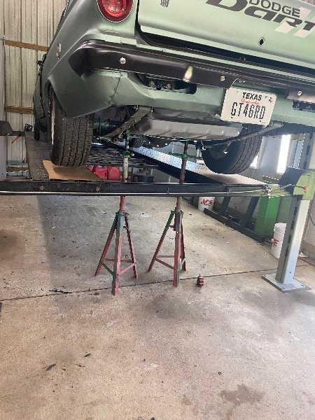

just the calculation is messing with me to determine the offset. So I'm going to put the Dart on the 4 post lift in a little bit to start figuring out what I need for a offset. If you guys have an suggestions, I'm listening as always;) I did make the suggestion as I'd like to have one tire removed to see where the tire should be in the well, of he said sure.
See which side is actually rubbing. You can cheat the rear end over to the other side to gain clearance needed.

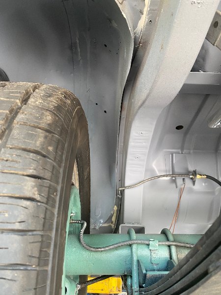

Yeah I know, kind of pricey, both sides are rubbing pretty good, and I haven’t even driven semi aggressively. I dropped off one wheel, The guy is calculating what backspace is needed. I’ve spent a fair amount of money on this build, another grand isn’t going hurt my feelings ;) probably my last build so I want to do it right;)

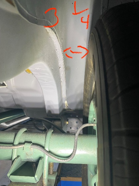

Looks like that 8 1/4 rear end setup is just a hair too wide for your A body.
I can see where the "Rub" is on the outer inner wheel house.
