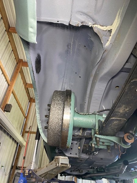

Your Dart has even tighter rear wheel clearance than the '67 - '69 Darts and those are pretty tight.
Here is a '67 Dart with 14 x 7 slots. With the 8 3/4 rear end. And the short big block leaf on the original leaf stacks.
Sold it to a guy I know and he had a slight rub when he put people in the back seat.
So as a precaution he put on the Monroe Max load leveler shocks for a safety barrier from rubbing. That took care of the rubbing issue, and still retained the nice ride.
Really doesn't take much air, like 25 psi or less.
And like said other day by someone, usually the rear axle is not perfectly centered. Same wheel and tires on rear, one side might rub a little and other not.
I would still have a muscle guy hit the wheel housing good with a big hammer.

What kind of bites is they (tire store) can't mount the tire onto the new rim(which I can understand), but they'll allow me to have the rim to mount cautiously and do a visual. My feeble thinking it has to be better than what I currently have, right? So, just buy the darned wheels and still do the inner fender "adjustment". I did find a sway bar that would fit. that may help too? My leafs are right at 32's apart (inside leaf to inside leaf), this particular company has a bar that's 25" eyelet to eyelet.

Upon further inspection looks like you have too much tire for that 7" wide rim. Pushing out beyond the width of the rim, rubbing on your inner wheel house.
Guessing they are the BF Goodrich Radial T/As 235 60/15 with a diameter of 26".
Website shows 9" wide tread face on the 7" rim.
