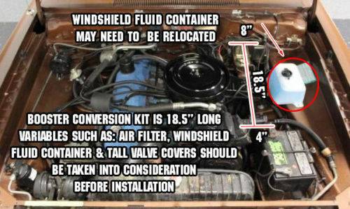

Pirate Jack is the only site I've found that provides this image to understand fitment and space requirements under the hood...
A ++
