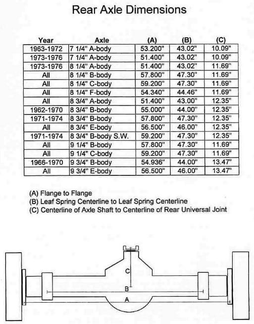

From my 69 FSM it says for a Dart (same 11 in WB as the 65), the length of the driveshaft should be 52.27 in from C/L to C/L of the U joints. This is for an LA motor with 904 and 8.75 axle. Just for info, if with a 4 speed and 8.75 it is 51.96. All driveshafts are 3 in in diameter and some have the IVA (Internal Vibration Absorber at the front u joint.
EDIT: BTW will be doing the same set up in my 65 'vert - 340/904/8.75
The best way to get the correct length drive shaft would be to figure out how much longer the 8.75 rear end is. Drive shaft number lengths are all over the place.
Using the "C" dimensions 12.35" less 10.09" equals 2.26" shorter than your original shaft length.

should be the same as my 70 if its a 112 wheelbase, I went from a /6/904/ 7 1/4 to a 360/904/ 8 3/4 and wound up with 52 1/2 after careful measurement which is only a 1/4 inch off of what 65dartman said the book gives

If the rear is in the car, why not just measure from the flange on the rear of the trans, to the center of the u-joint cup in the rear yoke? If not using the 65 trans with the flange, just put the slip yoke all the way into the trans, pull it out about 1 inch and measure from u-joint to u-joint centers. Doo this with the suspension loaded.
