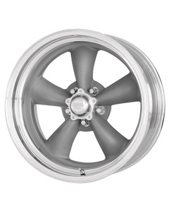

I know I'll probably have to refine my question, but has anyone been able to fit 15x7 4" BS VN215 Torque Thrust ll's over an 11" drum? I got some info from Summit that said the inside surface that bolts to the drum is 12-1/4" dia., but that's all they could tell me. The 11" drums start at 11-1/4" and taper out to about 13-1/2" dia. in 4-1/2" of depth. No one could come up with a reasonable answer, so here I am. Again.
Another possible option is 16x8 4.89 BS, but I don't know if I can get them under the car. Any help would be appreciated. If I sound confused, it's because I am. Thanks.
