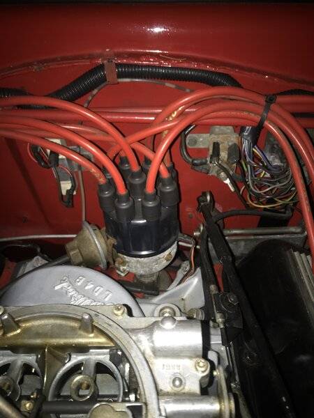

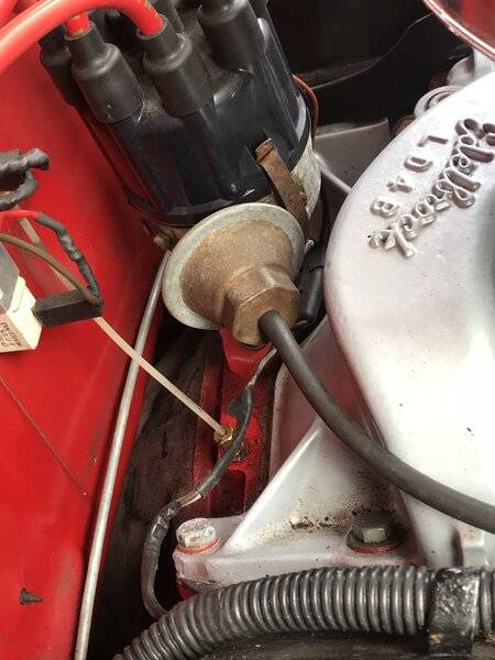

View attachment 1715531626 Here’s where my distributor is on my 273 charger engine with edelbrock and LD4B mopar electronic ignition.
Thanks. My #1 is facing directly to the front. Between 8 and 2 Your 1 and 8 are beside each other. If that makes sense heres a pic. Your front two are side by side my #1 is directly facing front ward. That's why I'm thinking I may be one plug off to the left and not getting correct timing. Or am I overthinking? My brains hurting the wires you see are for my trigger pull so I can do everything under the hood.
I can get you a pic of where my number 1 on my distributor is pointing here in about 30m. Yours does look little to much in center.
