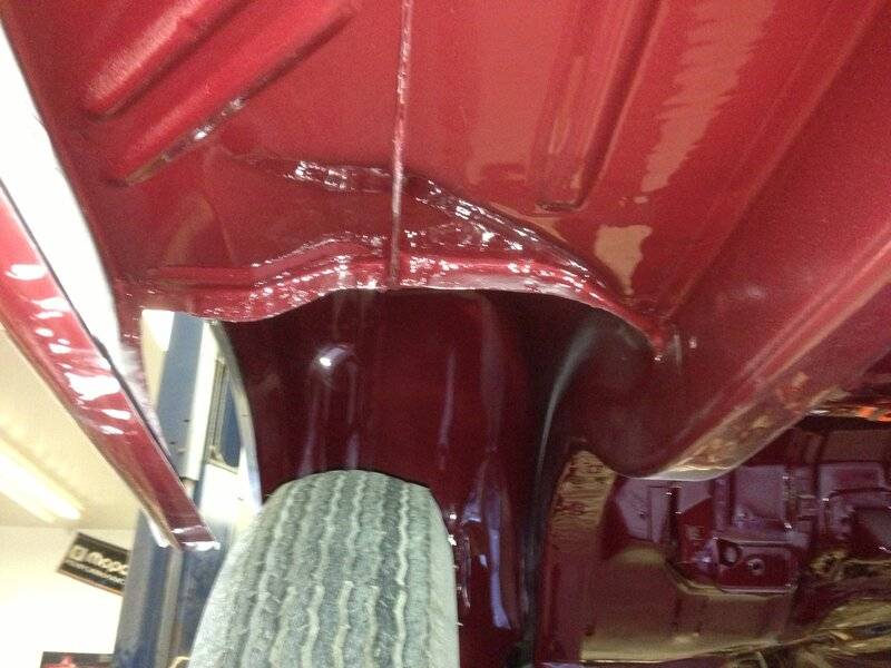

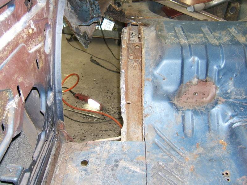

I did mine a little different than what I usually see. I took it off of the frame rail and cut some of the floor off. I also rolled the lip of the frame rail over for some added clearance.
