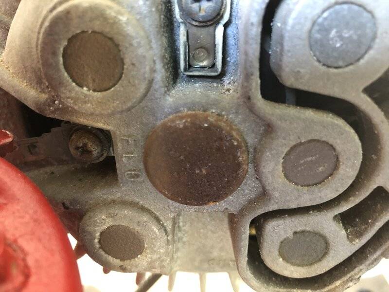

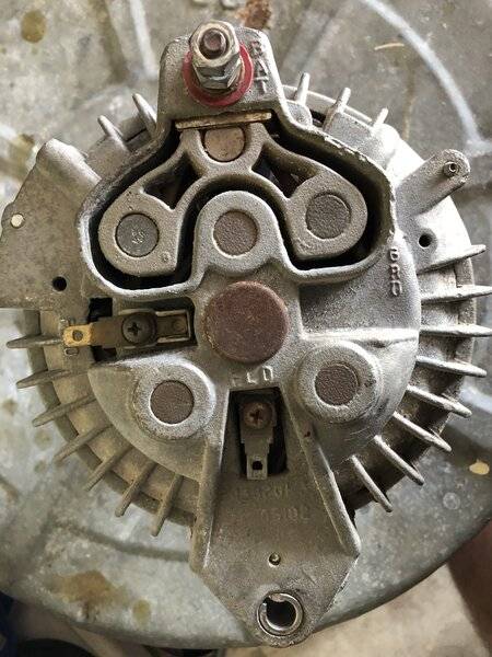

No numbers left on alt. Any idea if it should have one or two FLD connections (as seen in the photo). Is this normal?

There's a way to ground the extra field terminal that you don't need...

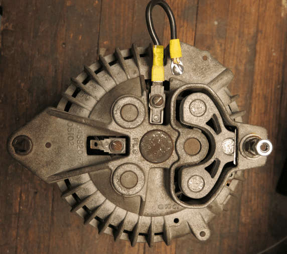

What is going is this. Sometimes its easier to pick up an alternator with two filed terminals and ground one of them. I've had to do that on several occasions.
Here's one

Please read carefully what is being posted here. Regardless of "round back" or "square back" a round back can have ONE or TWO field connections. The two is known as ISOLATED FIELD and was used starting in '70 but!!!........
There are TWO regulators. The "up through 69" regulator hooks to switched ignition power and the field wire and you ground it. Done That is used with a single terminal field alternator. If you have TWO simply ground the remaining field
The flat looking electronic used in 70/ later wires exactly the same EXCEPT the alternator must have two field connections, and the last field terminal is wired to switched ignition power.
So the "flat" 70/ later gets ground, ignition power, wire to one field, and second field goes to switched power
The early 69/ earlier regulator gets ground, ignition power, and wire to the only field connection
Simple

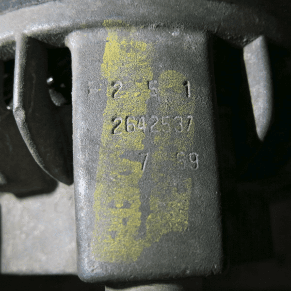

The part number probably got sandblasted off during one or more rebuilds.
If its anywhere, its here. But as its rebuild, who knows if the original rotor and stator are in it?

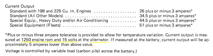

The test specs in the '67 service manual are not the rating.
This is snip from a '69 or '70 FSM but the point is that its a maximum load test at 1250 engine rpm, 15 Volts.
We can sometimes relate the test specs to the Chrysler alternator 'rating' by looking for the same description in other books.
This is from the dealer data book.
