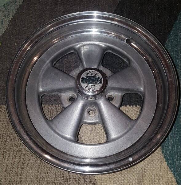

Have an old school set of Cragar Sparklers I want to use on the front, except they are 14x6 with a backspace of 4 and 1/16th.
Anyone running a front 14x6 with a 4" bs, if so what tire?

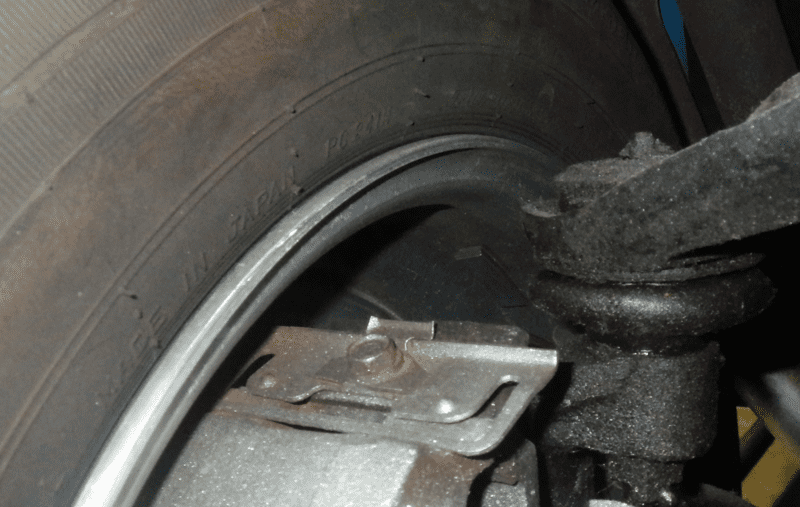

14x6 with a 4" bs do not fit on the front of a 67 Barracuda with QA1 UCA.
The wheel rubs on the UCA once the wheel is not pointed straight.

15X7 with a 4.5 bs will not clear the UCA on a Barracuda.
Every wheel I've tried fits the KH disc, but ones with a bs > 3.75 hit the UCA.

I had these SBC Cragar on my '69 for years before I swapped in '74 Dart discs for the drums.........
Still holding the vintage air too.
15 X 5 - 3-1/2 BS Welds on now with 165SR15s.......
