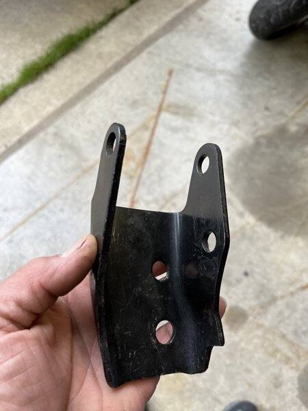

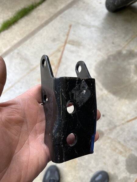

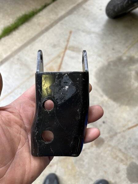

8 sets left this is the last single I have and the last one to be sold by me on this forum due to Steve giving my name to OP and the respectful way I was asked for one. It will be in the mail tomorrow.
