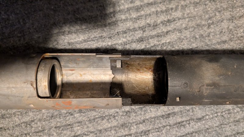

You had a better starting point than I with a floor shift column. Picture below shows a gap between the outer tube and lower column collar for my setup. Can you measure the inside diameter at the bottom from the 68 lower column collar? That might give me an idea of the after market column parts would fit. Worst case maybe open it up for the wiring harness cover.
Intent was to swap to Manual steering with the aftermarket shaft adapter for the added length.....unless I can get a manual shaft.
My 67 Floor shift collar and my 68 column shift collar have the same bottom ID 2.88"
