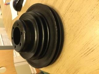

Is this it?
I Need Info On 1968 340 pulleys
The above is a thread with lots of good info
I think this is off of a 66-67 273. Doesn’t seem to have a part # I can see. I couldn’t use it on my 360 because of the balance difference. I think it would work on a 340. AC parts are really hard to find.
That does look like the one I am being told that I need, but like you said no one has a part number. I started that thread that you have listed above and if you go back in it, it states that none of the pulleys in this thread are for factory A/C cars and that pulley you have there is not in that thread. Mike is that pulley for sale?
Bob
Yep, how about $40 + shipping. It will fit in a med flat rate box. Think that is about $16.

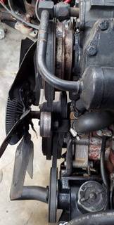

I received some pictures from Jim (RealWing) who has an un-molested 1969 barracuda 340 S with A/C and Power steering. These pictures answer some of the questions about this puzzle for the correct pulley and the way everything goes together. Take a look.
Thanks
Jim

You are welcome. Hope you can find all the parts!!!

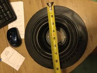

This is my original 68 340 AC with power steering crank pulley. No numbers I could see.
I believe that the water pump pulley is larger because the pump is a 8 vane pump on AC cars. IIRC.
Yes that is the lower crank pulley that I am looking for. If you look closer to the top of this thread Jim (RealWing) sent me pictures of his original 340 with air and power steering lower crank pulley and it looks just like your's. The part number is 2536752 but the problem is that the part number is not on the pulley (good job engineers)
