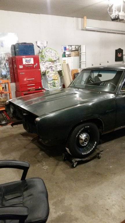

Hey guys I am starting a tread about the progress of my 68 Barracuda 383s paint resto. I am looking to give the car a driver paint job, not looking for a Mona Lisa just something to drive around and enjoy with the wife and kids. Speaking of kids that's one reason why I will have limited time to spend on the car. And also as most know kids are reducing my budget also.. I am pretty much a rookie painter so advice will be appreciated. I am looking to keep the windows intact and doors and fenders if possible. I already rebuild the engine and painted the engine bay with single stage GG1 PPG paint myself. So the engine will be staying in.. here are some pics of the car a few weeks ago and it's current state.. I don't mind spending money on good products and it's a possibility I might even get it ready gor color and have the car painted elsewhere... thanks

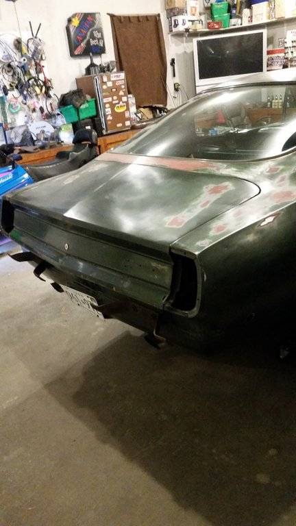

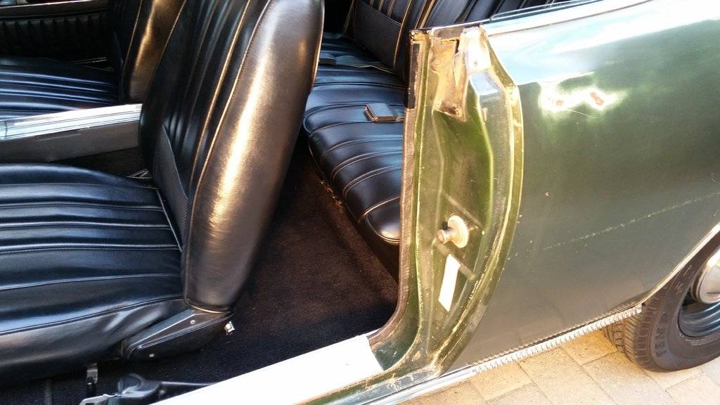

Few more.. I know how you guys like your pictures. .
I'd leave it alone and enjoy it instead of painting it and worrying about people scratching or denting it.
I have drove for 2 years in this condition. .. time for a little change.
Pretty sweet patina you have going there.
Engine bay does look good, though.

Sounds like a good plan JDmopar. What do you suggest I do with the jams and inside the doors and underside of decklid? I would like to just scuff and prime..
Strip it all the way to the metal! Last one I did, I used some sanding discs for a 4" grinder. They look like a scuff pad, but they're stiff. I got them at Lowes, and it takes about one per panel. They were $7 each at the time, but may be a little more now. They won't heat the metal up and warp it like sanding discs on a big grinder. You could use Aircraft Stripper, but if you don't get it all off the car when you're done....it can ruin your new paint later. Use epoxy primer on the bare metal after you clean it with wax and grease remover, and do any filler work OVER the epoxy primer. Use a good 2K primer for all your blocking. Alternating between dark gray and light gray primer between sanding will help define low and high spots. If you decide to paint it yourself, practice on an old hood or something before you tackle the base clear. There's a lot of educational painting videos on You Tube. Good luck....and kudos to you for not being afraid to tackle it yourself!
red scotch brite. If he paint is in ok shape in the jambs and under the hood and trunk you can scuff it and shoot it. No need to strip it. For the out side I would strip it. epoxy prime, Do any body work that needs to be done. Then high build primer, block and shoot.
Darren....I agree with AdamR on the jambs and under the hood + trunk. I did exactly that on the last car I stripped. You might as well expect to get a hunk or 2 torn out of your fingers in the jamb/trunk/underhood sanding process! Some of the factory spot welds may have a sharp piece of slag sticking up.....and are hard to see! Your finger tips only hurt for a month or 2 though. :eek:
