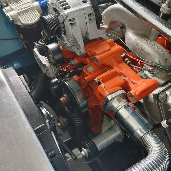

Have a 06 Durango hemi with short pullies and tensioners in my 68 Dart and trying to find the pully tower for drivers side with P/S delete. One I ordered is to long. Does this part exist?
Is it solid or hollow? If solid, you could just cut it down to your desired length and tap it for the screw...
You will have to shorten it. Reason being, is they came out with that part after 09, or when the Eagke engines came out. The accessory drive out front is spaced different between early(03-08) and the Eagle(09-present). From what we can see, nice build! They like those dual fours!
Thx for the info. Wow, how on earth can you possibly know its a dual quad setup??
