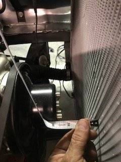

            Zigs can you post picture of your Ford Torus electric fan setup. Is the article in the A-bodies only forum?

            Online. Look up " Using AFord Taurus fan ". Several articles you can read. You have to be careful because they used two different fans. You want years 87 to 93 in the big V6 or 8's. You can also do a search on here.

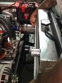

            They are a two speed fan . I was told but have no proof , that low speed pushes around 3000 cfm and high speed 4500. I have only the low speed hooked up.

            Zigs, I got the 1993 Ford Tarus electric fan but the Fan is still is to deep and will hit the water pump pulley. It seems from your pictures your Radiator is relocated in front of the core support is that correct? i have attached a couple pictures of the fan spacing issue.

            Well not much core left. I'm using a 26" radiator had to to some trimming. If you notice the fan set to the driver side and down. I'll see if I can get better pictures.

            I should mention I'm running a 26" Northern. I have no original radiator left. Made my own supports. In the pictures you'll see my finger inbetwee
            I should mention. That I have a Northern 26" radiator 27" over all . I have no original rad support , made my own brackets. If you notice picture with my finger in it, that's the space between water pulley and fan. Also you will notice that my fan sets to the left and down from the pulley. You may have to do some tweeking if fan doesn't slide down . If need be remove top hose , if not already done. Also you can trim plastic around motor with drummel
