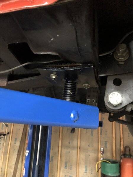

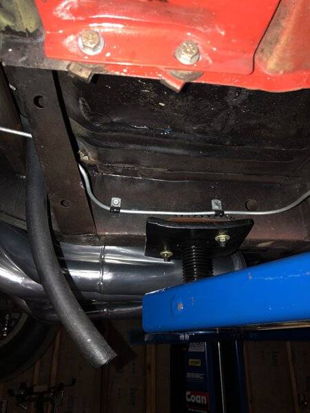

Do we have any members on the board woth a 340/383 a body with 4 or 0 torque boxes. I have only seen 4 on a convertible when it comes to a body cars. To clarify, did the LO23 and BO23 cars have all 4 torque boxes?
My 383 car just has the rears. If I make it out to the garage today I’ll snap a pic. It’s on the hoist. I’ve been told they took the 383 bodies to make the hurst cars from. Think I read that as well. Only cars I’ve seen 4 on were convertibles. I will also say my dad 340’gts didn’t have any. Don’t think the 340 swinger in the garage does either.
