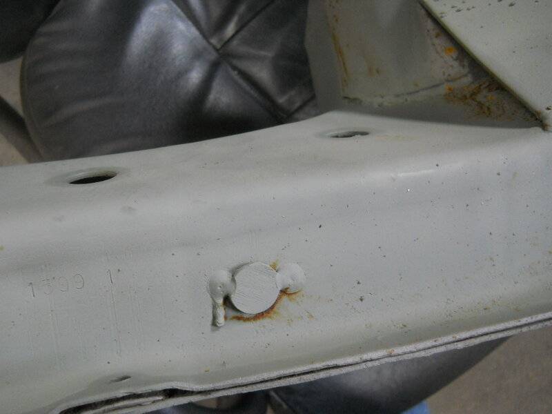

Maybe someone can help me out. I bought a v8 k member awhile back and it has a washer welded on the front surface of the k member. I know they used that in 70, my road runner k member had it on it.
When did they start that?
Has the 67-69 style anti sway bar mount holes drilled in it.
I've typically seen that on 68 and 69 A body K members when they were 340 (68 - Formula S / GTS) cars. I haven't inspected enough BB 383 cars to know if it was a SB K member only thing. All the 67-69 A Body K members I've see had the sway bar holes drilled into them. Supposedly, the welded washer was to let the guys down the line know it was a Hi-Po car??? Maybe those are the cars (outside of the 'verts that got the torque boxes? IDK. I know there were older discussions along these lines... is that what you were looking for?
Yes thank you. Oddly my 68 formula S 340 doesn't have the washer welded on it. But has original looking anti sway mounted to it. January 68 build date.
as far as I know it was NOT a consistent thing, could have been a SHIFT thing who knows what they did back in the day... I don't think my old 68 340 S 'vert had one either, however my car was definitely hit in the front driver side at one time so it might have been changed as well, or It MIGHT have NEVER had it.

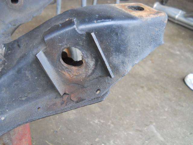

Designates its a reinforced K-member. Look for the half washer welded around the Lower control arm hole as pictured. Noticed a difference inside when cutting them apart for modification. Some of them Have the center of the washer as picture.
Thought I would post the last picture of what happens to a K-member when the strut rod bushing doesn't have a shear sleeve. This should stir up a novel.
But oddly my original 68 340 formula S k member isn't reinforced. Must've been a mid year thing
Or it was a Monday or a Friday or somewhere in the last ~55 years things were changed. LOL.:lol:
Both of my 69 340 cars had the front washer on the front of the K.
