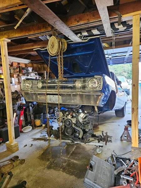

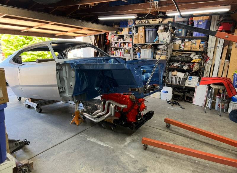

I'd do it this way.
Where are ya hooking those chains to yank the car up in the air?
1/4" thick square tube cut to fit snug under the frame rails. Welded a couple of bolts near center to keep the chain from moving side to side.

with only a 7 ft ceiling , I did it all the hard way ...starter at the same time as the TTI headers ...
