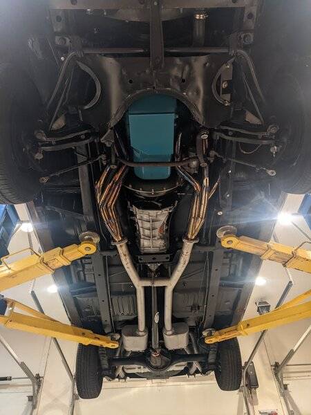

Finally got car over where two post lift is so the crawling on the ground monkey business is over ...
Seems like starter squeal issue went away? I don't hear exhaust or drive train hitting body anymore? So those problems just disappear some how? Like car gods or something? Car is smooth going down the road trans and clutch feel good. Stepped on it a tad in second broke tires loose. Can feel rigidity of body from new floor and sub frame connectors.

Was able to get some more clearance between tail pipe and frame rail. Was 1/8 inch maybe little less. Just put pressure on two bolt flange after muffler while tightening and that made pipe move away from frame rail a tad. Everything is easy with car on lift.
