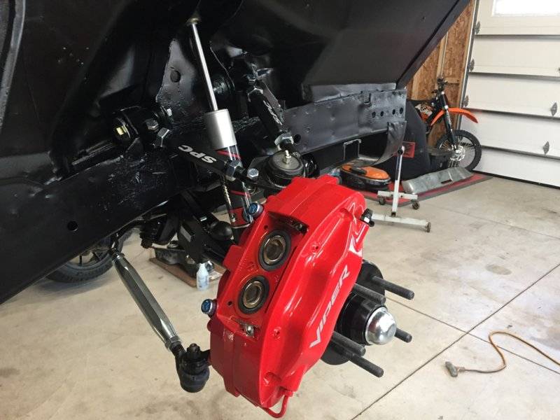

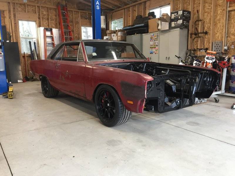

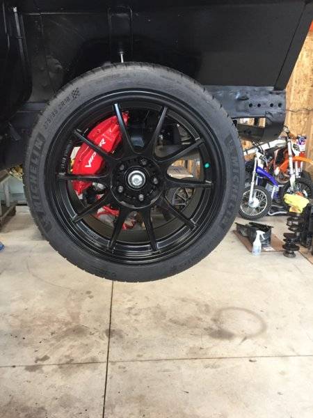

Some more progress today. I put the original TBs back I in while I’m waiting on the 1.14”s. Then i could install the hubs and calipers. I’m still waiting on the 2 piece rotors to be assembled so I cannot shim the calipers. Then I’ve been dreading the next step, grinding out the outer wheel center’s on my brand new wheels. Luckily it went well and I took my time with a large Aluminum carbide burr and lots of WD40. I was able to get it back to a roller. I can’t express how happy I am with the look of this car. I know i’m going against the norm of fatties and skinnies, but I really think the car looks great with the wide squared look. Tomorrow I’ll get the inner fender wells painted so I can get the fenders back on and really see how it will look and more importantly, how the wheels fit in relationship to the fender arches. I had to get a pic next to my other project that was put on hold, my 81’ Bronco Ranger.

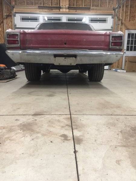

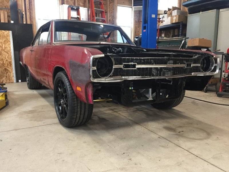

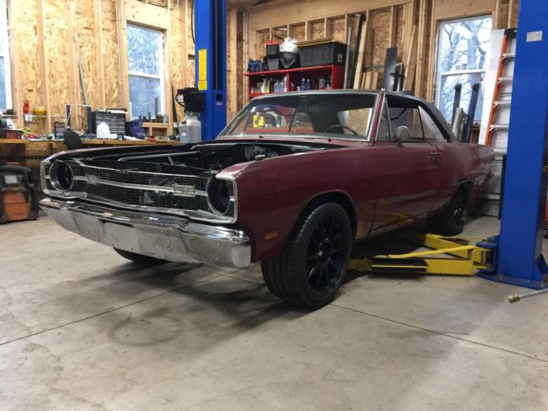

I was able to clean and paint the back sides of the fenders yesterday and today. Then I hung them with all the original spacers and they went back on just like they came off. I just can’t get over the stance of this car! The front needs to come down more with the weight of the engine still. I’m just floored at how good it looks despite the horrible old paint. A friend of mine seems to think we can buff it and it will look much better, but I have little expectations of that.
The Firm Feel torsion bars arrived today along with their poly grease boots. They took some beating to get in because of the thick powder coat, but they’re in. I couldn’t help but put the front end back together to get a new lowered ride height pic. I think the front end will be an inch higher or so when it’s all dialed in.
have you checked the tire clearance at full lock yet?
Yes, and actually it clears everything including the fenders. It’s super close though. I will probably raise the front end an inch or so when the car is fully assembled and at full weight. Otherwise, I may need to roll the front fenders a touch

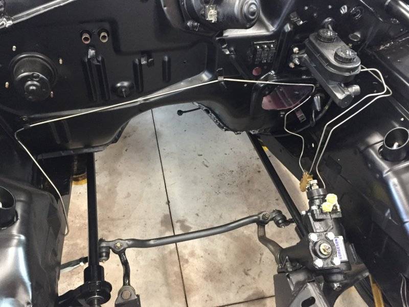

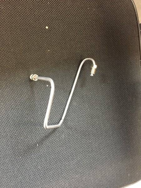

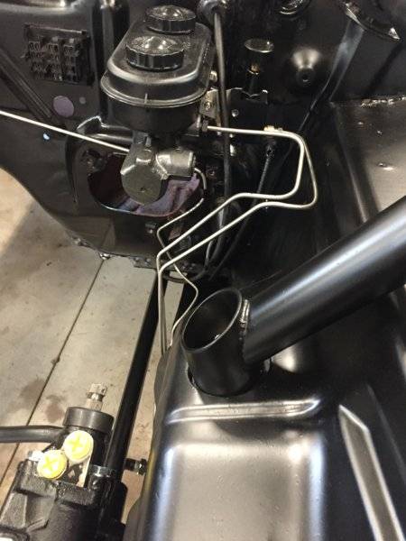

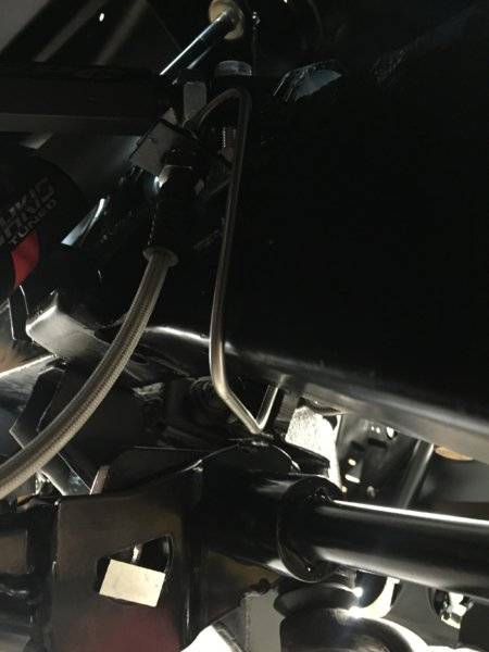

Well, started on bending up new stainless brake lines today. I got 3 done and ran out of brake line.

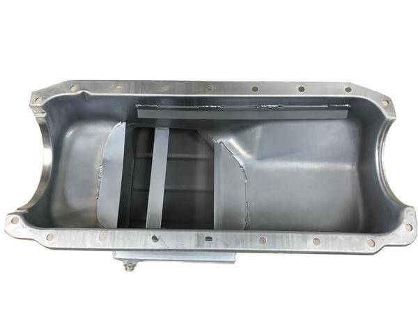

I started off this morning by placing a pretty large order with Summit for the brake line and a bunch of engine parts. Then, on the recommendation of another member here, I called Kevco racing and ordered one of their road racing oil pans and pick-up tube. Great customer service with Kevco. Then I fab’d an aluminum mount for my B&M supercooler oil cooler. That way I could get it mounted and get the grille back on. I spent a few hours cleaning, polishing, and straightening the grille. It’s still pretty aged looking, but it matches the cars paint job lol.
Today’s progress so far. My rotors came in from Baer so I was able to get my front brakes finished up. Also, the Kevko pan and pick up I ordered yesterday arrived today. I’m pretty happy with the quality and I think It will serve me just fine.
After a few days off, I was back on the Dart today. I rebuilt and installed the steering coupler with the BAC direct fit coupler. I ended up reusing the original shoes and spring because they were still in excellent condition. I bought the BAC coupler boot that replaces the crimp on original boot. Not sure if I am sold on it. Seems to spit a lot of grease out every time the steering shaft is rotated. Maybe it will eventually stop when enough grease has pushed out. I also finished the last 2 brake lines so those are done now.

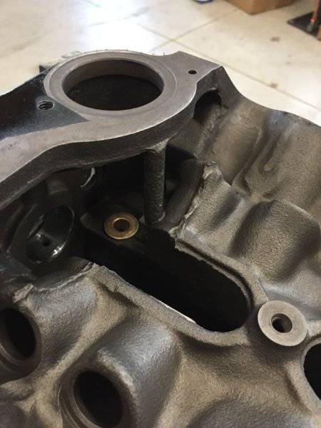

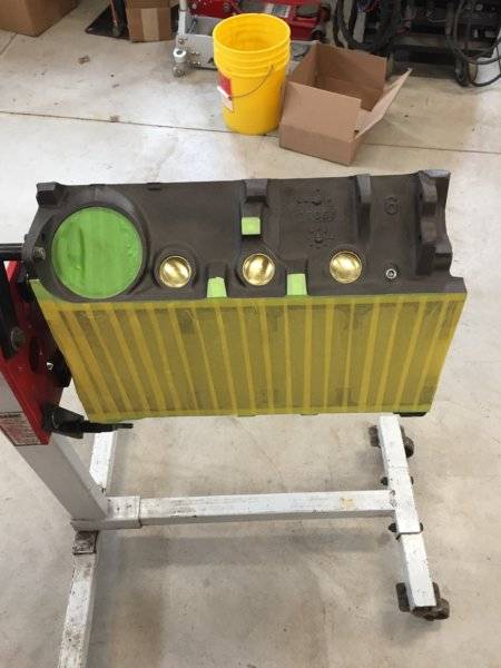

I picked up my block yesterday and tried to drop of my rods to get the pistons pressed on but that didn’t happen. I was sent +.040” pistons instead of STD bore pistons that I need. Hopefully the correct ones will show up sooner then later so I can assemble this engine. I had the crank polished as well. My son and I fit the main caps and installed a new bronze distributor bushing while we wait.

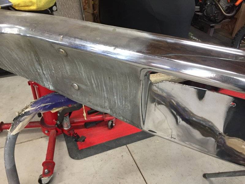

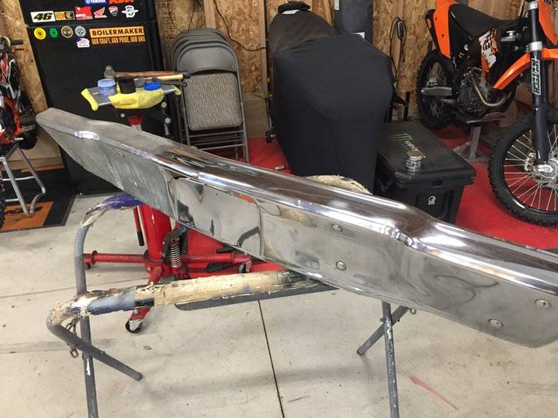

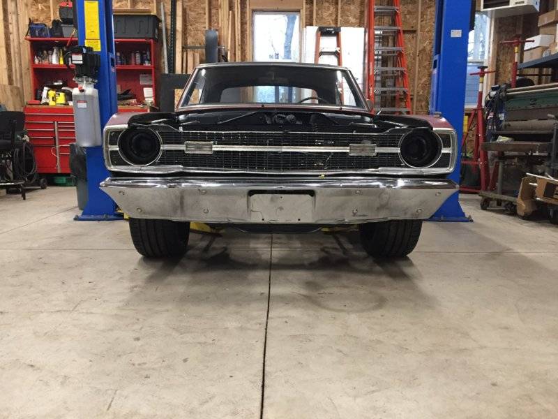

I’ve also been working on polishing the front bumper so I can put it back on. What a huge pain in the *** removing 51 years of grime and hand polishing it back as best I can. So far it’s taken about an hour to do half of it. But I only do 15min at a time until I go do something better lol.
I finished polishing the bumper and then decided to paint the brackets before I reinstalled the bumper. It’s nice seeing it back together looking more like a car again.
