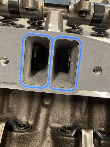

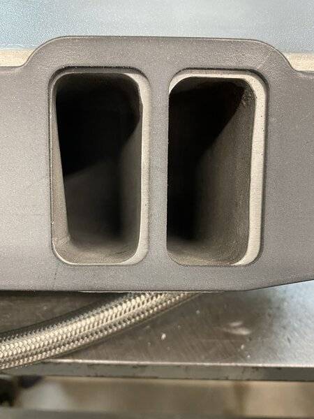

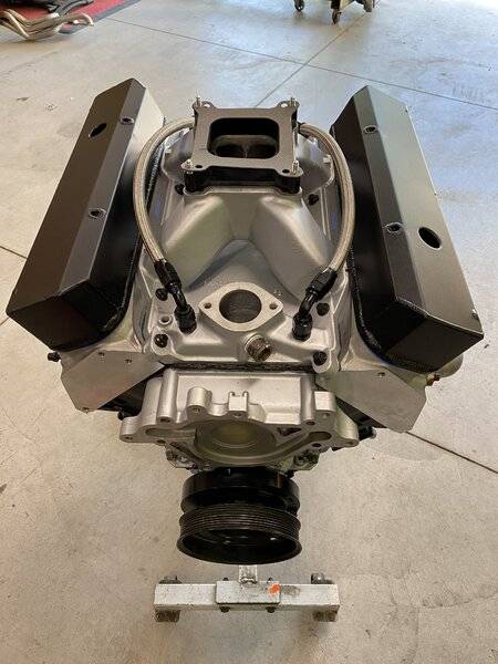

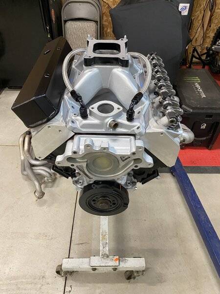

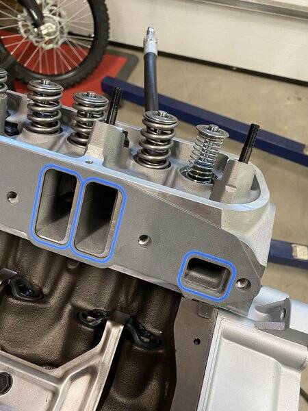

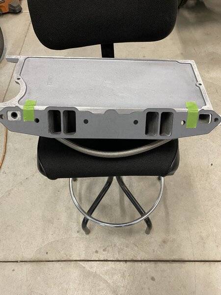

They were not. I drilled and tapped them to 3/8” NPT. The ID of the -8 AN and 3/8” NPT are the same so I felt no need to go to 1/2”NPT. Plus the smaller the hole in the intake, the less chance of cracking the aluminum when you tighten the fitting.

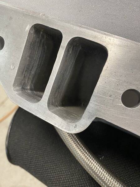

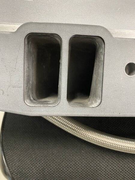

Final port match on the M1. The Speedmaster heads are near perfectly matching the gaskets so I didn’t bother.

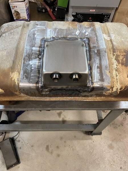

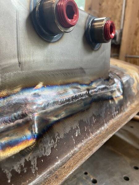

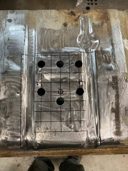

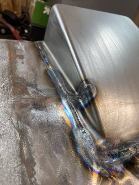

Little more progress today. My sump cane in so I fit and welded it in. I still need to leak test it and then paint the tank black.

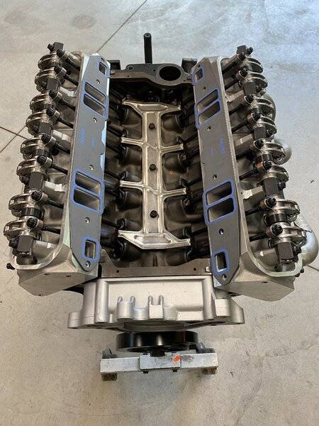

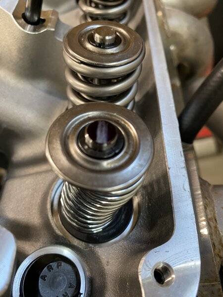

I was able to measure and pick up the correct pushrods today. Then my son gave a hand adjusting the valves before I assembled the remainder of the engine.

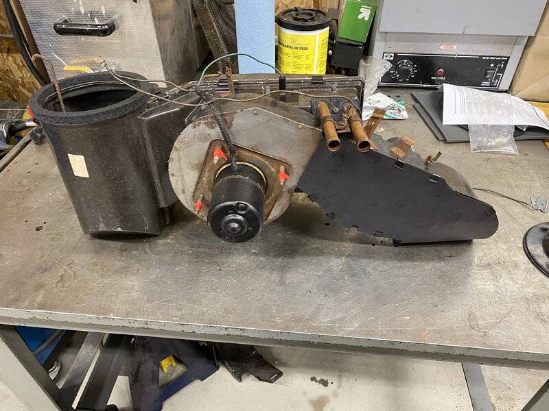

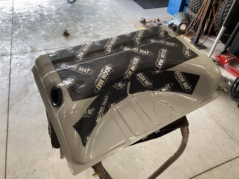

Back on the Dart today. I finished welding the sump on the original fuel tank. Then I cleaned it out and leak tested it with zero leaks. My kids spent about an hour removing the items my brother and I stuffed down the filler neck 30+ years ago. I removed the factory undercoating, prepped and painted it. I also had time to reassemble the heater box with the new heater core and all new foam, clips, and seals.
Looking great. What paint did you use in the gas tank?
Thank you. It’s just Rustoleum Professional grey spray paint. I plan to replace the tank in a year or so with an Aeromotive tank so I just wanted to clean it up and paint it since it was pretty gross.

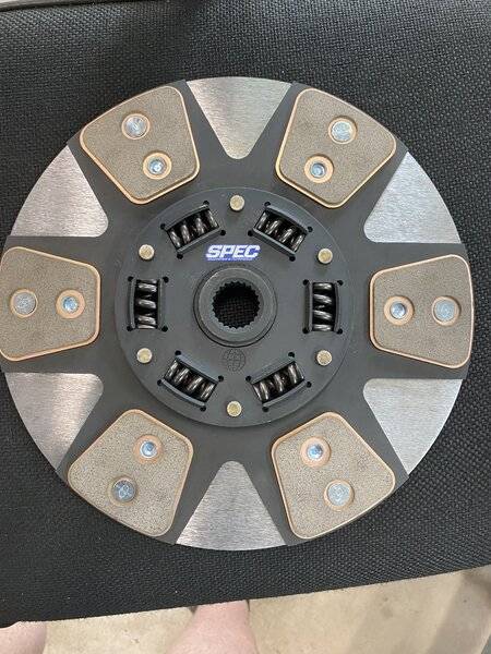

Also, my Spec clutch came in. I ran a similar clutch on my sand drag Jeep with great luck. HD Luk clutches would only last 800 miles and then I switched to a Spec clutch and never had a problem in 5,000 miles. With my plans for this car, I didn’t want to mess around.

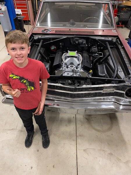

My son and I were able to drop the engine it today. I need to fabricate serpentine accessory mounts and I want to make sure they all clear. It good to see an engine sitting in there, last time there was an engine in the car was 1996 LOL
