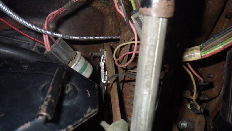

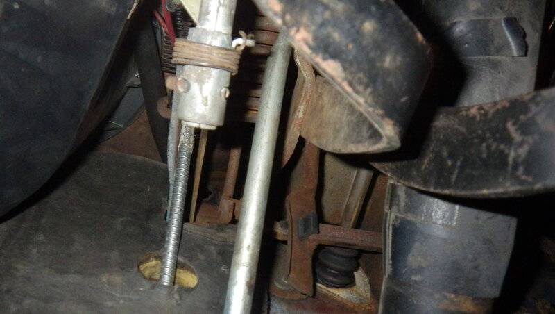

Sep 5, 2025 #1 moparhunter Well-Known Member Joined Oct 5, 2006 Messages 797 Reaction score 238 My car has been apart for 25 years. I can’t remember how to put back the emergency brake cable under dash anybody got pictures ?

Sep 6, 2025 #5 Daves69 Well-Known Member Joined Feb 20, 2011 Messages 8,196 Reaction score 7,715 Location WestOfChi Kind of a PITA especially with the HD clutch pedal on my '69 Barracuda..... Last edited: Sep 6, 2025
Sep 6, 2025 #6 E etngeorge FABO Gold Member FABO Gold Member Joined Jul 24, 2013 Messages 113 Reaction score 61 Location Dandridge,Tn I just did that last week. Mine is auto so maybe a little easier than yours. Install the grommet in firewall before connecting under dash. Learned that the hard way. Photo is not best but maybe helps.
