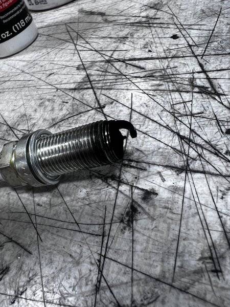

I pulled a plug and it was coated in soot, insanely rich. What finally got me down to a decent idle was taking a guess at my actual injector size and putting in 650 vs 455 and the idle cleaned up a lot. So I’m hoping having appropriately known sized injectors will help shorten the path to a decent tune.

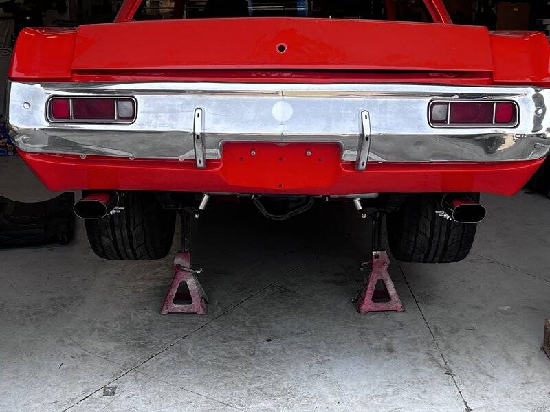

Pic of the exhaust tips running out the back. This was before the final hangers were installed so they’re actually even height. I used V band flanges on the mufflers in front of the rear axle so it’s an easy system to take out. You can snake them out the back pretty easy then the collectors just unbolt. Hanger locations are the rear seat bolts and the old rear leaf spring hanger locations.
So far around the block it sounds very good and no drone. We’ll see how it does on the highway.

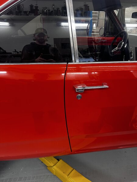

Front and rear glass goes in Monday. The doors and fender alignment on this car was total garbage. Striker in the passenger side was hiding a fully broken/cracked inner door. Seam sealer around the glass chrome was in the way, someone had hammer/dolly some of the fender corners into alignment near windshield, lots and lots of small problems like that. However he worked his magic and the doors line up fantastic and they close and open sooooo sweet and solid.
Hood has some misalignment but it’s the nature of this particular fiberglass hood. Not worried about it at the moment.
