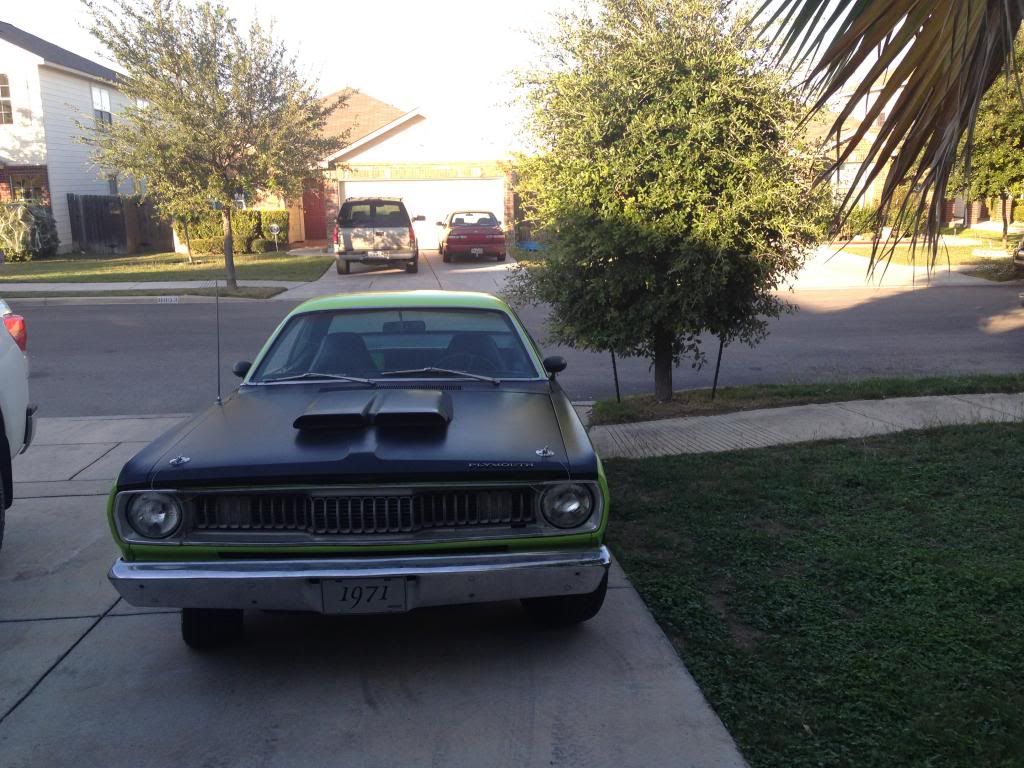

Hello all! Been gone for some time. I picked up 71 340 Duster tonight from the 2nd owner. Numbers match on engine, Vin, door, rad support etc. The fender tag is long gone but I have the build sheet. Any help decoding? Is this a V24 car? Also wondering what color the seats are supposed to be. Has a flawless sharktooth but the guy painted it sublime green. Nice looking and running car but im particular and want it to be correct. Yes, I know the sequence number is gone, I rubbed it out. Can anyone help me decode?

Yes it has V24 listed right next to your GF7 paint code.
You mention that car/grill is Sublime green but car is coded for a medium Green I think called Sherwood Green.
Also when you see 5x8 listed as upper door paint (which your sheet has) that is Charcoal Upper door paint to go hand and hand with the V24 treatment.

Also your seats are L6X9 I think it's a bench not sure on the "6" but X9 is black.
I'm going to guess you have a Black Bench without armrest which is a standard interior, is that what is present?

Dont worry all, I have a flat hood without a scoop ready to install in place of the present hood. Also plan on the spoiler going away.
