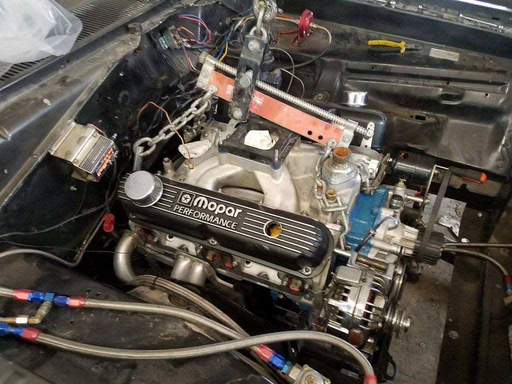

got the motor in the car this afternoon....
nice thunderstorm cool things off..
couple of pictures before i took it off the stand...and dropped it in...put the trans xmember under trans...then went home...soaked with sweat again.
Do you run a t-stat with your electric water pump? I noticed that your by-pass hose is blocked on the intake.
I have the same electric water pump and don't us a t-stat either. But do run the by-pass hose...............Hadn't real thought about it until i seen yours...............
The by-pass is just at. For when the t-stat is closed. I may have to rethink my by-pass hose.
Really don't need to by-pass the water back to the pump.
no thermostat...on/off switch...
My water pump turns on and off by itself as does my cooling fans. Two less things to think about at the starting line. Water pump turn on at 160 degrees and cooling fan come on at 185 Degrees.
