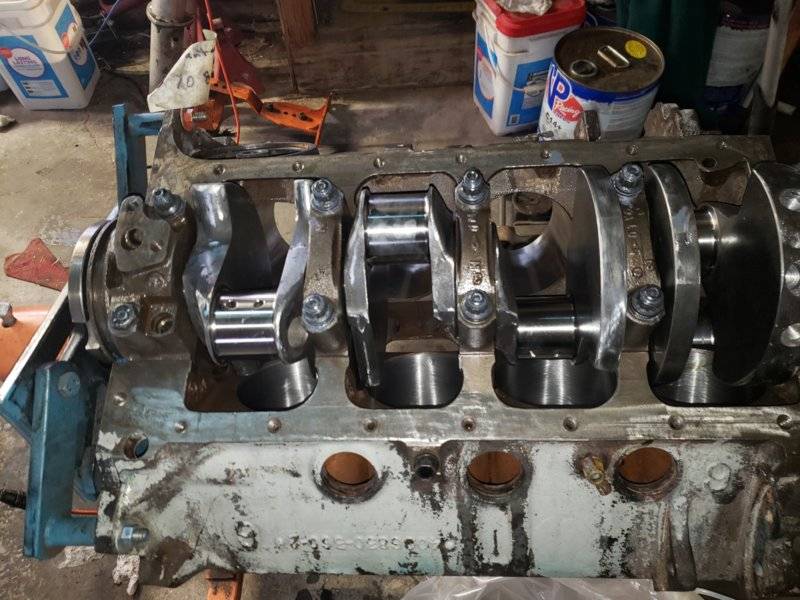

Birth of a Mopar 408..........Got the blocked washed and cleaned....wiped down the cylinders ....air pressure to dry it since it was raining in Vegas ,,,,cleaned again with brake cleaner......sprayed wd40 to keep from rusting...
Got the Scat 4340 4 inch stroke crank in place ....Clevite narrowed fully grooved main bearing...the lucas oil engine assembly did not want to flow...lol...

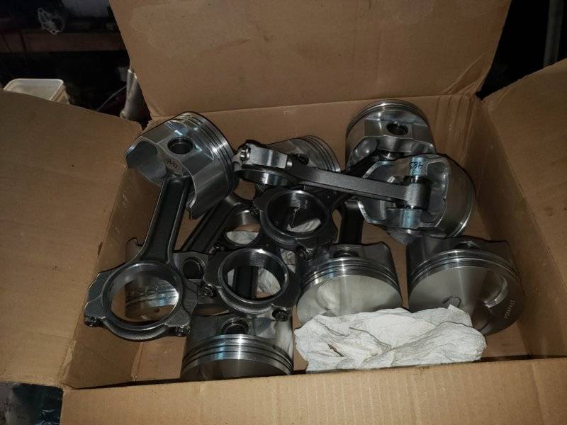

Scat rods and Pistons are made by Wiseco with a MP part number on them...I will write it down tomorrow...
picture of block and crank...plus pistons hanging on rods......need to get rings filed tomorrow....and should have them in the block by Saturday....got timing chain set coming out of Summit ...hopefully here tomorrow...so I can get the cam degreed in.....have no tracking number yet on the head gaskets.....have hughes cam and howard EDM lifters,,,,,,,

crap.........MP pistons P5007413...CH is 1.42,,,,,instead of 1.465
compression is calculated now at 11 to 1....should be easier on head gaskets
