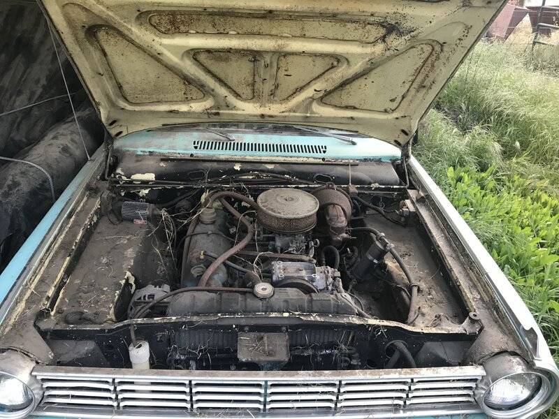

Anyone do this? I have a new Booster Dewey restored unit and some initial fitting before I stripped it down for blasting seems to indicate the '73 booster is going to hit the valve cover.
The pre-73 brake booster fits well. Does need minor linkage modification to work in an early A body.
Edit: By pre-73 I mean 67 to 72. The one in the pic below was from a 71 Duster 340.

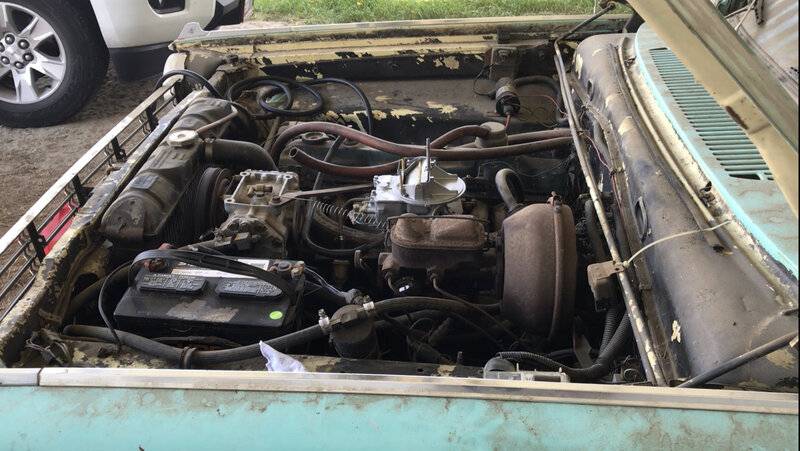

This was the powered setup in my car with a slant 6–this was in my car when I got it, so don’t know a whole bunch about it, except that it’s likely from a 1974 car.
Although it’s not what you are asking, it gives some reference. I’ve since switched to manual brakes.
