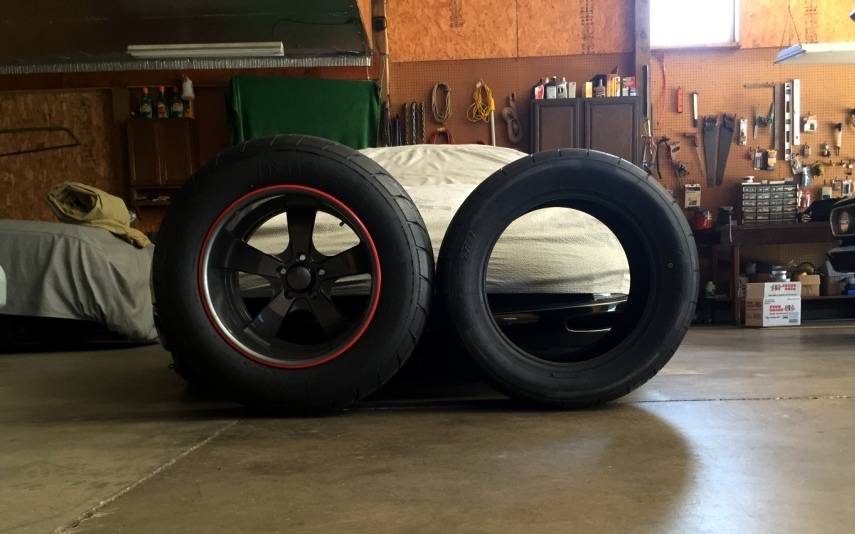

Well my time on one of the display stands at Summit Racing ended this morning, after stopping to fill the gas tank I decided to spend the day cruising around before taking the back tires off to swap them out for a set that are a little shorter. I loved the 390/40R17 but they rubbed when I took a sharp turn the opposite way of your typical Nascar race. I chose a set of 345/40R17 Toyo Proxis which are about 1 3/4" shorter overall but with the same width. It will solve my rubbing issue I might have to adjust my ride height some to get my stance back.

I'm glad Summit didn't tell me to get it out Friday morning........ I don't think the M&H are good in the snow. It was a choice between downgrading to a 12" wide tire and 1" of height or giving up a bit more height and keeping the same width.

I hate to see you lose tire height too because it looks so good but I think it'll still look good and not having it rub will be much easier on the nerves.
As long as it doesn't have that rubber band on a rim look, It still will have enough rubber to tuck up in the wheel well. Some people like that low profile tire look but it's not for me especially on a muscle car.
Definitely won't have the rubber band look as it still has plenty of sidewall. By the way, who do you trust to mount your tires without scratching the wheels?
The fronts are 26 1/4, the rears once inflated are suppose to measure 27 3/4". My 390's are 29 1/2".

thats the problem im running into. i can fit a 11.2 inch wide front tire just fine, but at a height around 25 inches roughly. I'll be running 18s so I should still have a 3-3.5 inch side wall. Or I can go with a 10.8 inch wide front tire at the height of 26 inches with a 4 inch sidewall. decisions decisions
did'nt you have any room to move the rear end back a 1/4 to make the the gap bigger in the front?
Yup. 28's are about the limit on stock Duster/Demon/Dart Sport rear wheel openings.....and that's
after moving the axle back 1/4".
