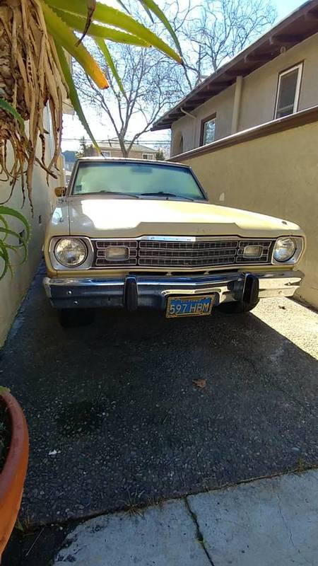

Hey all, it's been awhile. I just picked up '73 Scamp for 2800 bucks; have been looking for a fairly clean A-body for a long while and this one showed up locally on craigslist.
Is a big bolt pattern car with power brakes and disks in front, but sadly a 7 1/4 rear end, no idea what rear gear is in it. 318 with a tf 904, an eddy performer mani and 1406 600cfm vac sec carb, crap 2 inch dual exhaust, and HORRID 20 inch donk wheels on hub adapters. I already ordered a set of some cheap, but nice looking 15x7, 4.25 bs wheels off summit https://www.summitracing.com/parts/vsw-141h5765gm6 and some 225/60 15 all seasons, it should look MUCH better afterwards.
Luckily other than that, it's an early 73 car and it didn't get the heavy 5 mph shock bumpers. The interior is pretty clean and is has virtually no rust except just one tiny 1/8 inch hole at the bottom of the passenger a-pillar, gotta love Cali cars.
Here are some pictures of when I picked it up.
The trip home

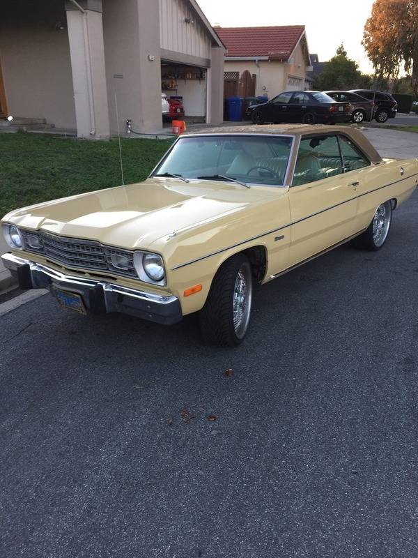

Decided to see how good this old paint was. The next day I clay bar'd, cut, buffed and waxed her, the results were more than what I expected.
She was really dirty haha.
Before
After
Damn it's amazing what a little elbow grease will do. The color is literally a shade darker.

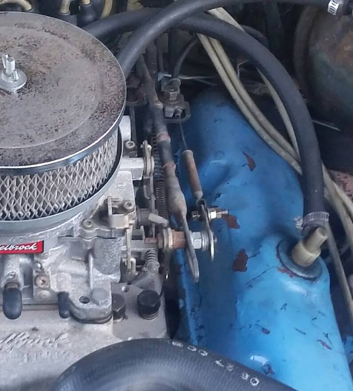

There after I fixed a few little things, she didn't pick up that well and the trans kick down didn't seem to work right. Ended up pickin up who knows how much horsepower because numbnuts who had it before me didn't set the throttle right, damn thing was only opening the butterflies about 60% with the pedal to the floor, and the kick down adjustment was barely engaging with the throttle applied. I reset everything and am happy to say she scoots a whole lot better than before haha!

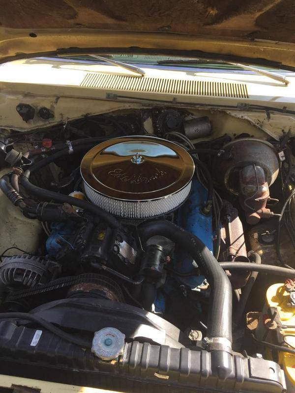

So I decided to clean this nasty engine bay.
After, much better.

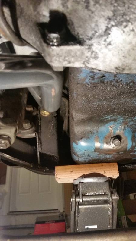

And so it begins, oh the joy of putting headers into A-bodies! So what do you do with a old 318? Put headers way too good for it on it! Started with quality Doug's headers haha.
Drained fluids and raised the motor up.
6AM and they are finally in, started at 1PM the day before. Tightening those God forsaken engine mounts to the block took a good chunk of it! No space to work when the motor is lowered into the position you want with the headers in the way.

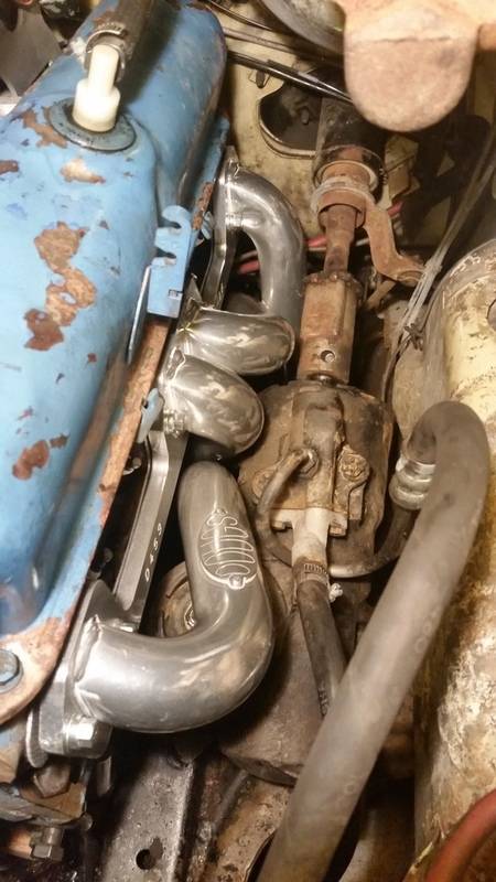

I guess I got lucky, I had no clearance issues, but damn, these things fit TIGHT. Following pictures show whoever what you might see if you're lucky to not have gotten a Monday or Friday car haha!

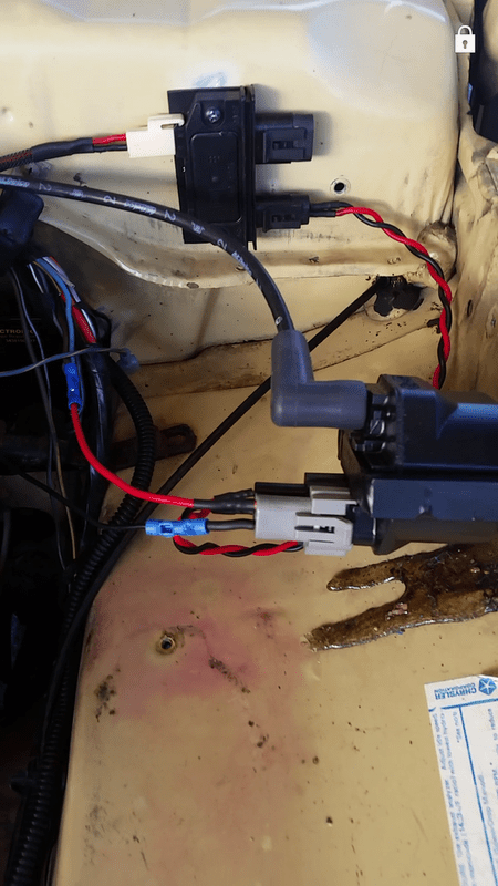

If I were to do another set of headers, I would DEFINITELY not cheap out and buy a set of Flowtechs!!!!! I had those on my 73 Dart, and flattened the front pipes within a couple weeks...... Your car is looking great in the short amount of time you've had it...... Looks like your ignition module did the same thing mine did, puked out all its insulation on the fenderwell!!!
Nice work! What challenges did you have removing the old exhaust manifolds? Many broken studs?
Haha, I know, it will all be gone within the week as I ended up getting Trailbeast's HEI setup.
Thanks! I let everything soak in WD40 for about an hour before I started taking it all off, wasn't too bad, aside from the rear driver stud because the previous owner looks to have broken it and the coolant hole was filled with RTV lol. Luckily nothing leaks.
Small update, bought TrailBeast's HEI conversion and distributor and put it in last weekend, YEEZUS, now that good **** made a difference! Didn't realize how worn out the old ignition system was. Idles damn smooth and the drivabilty of the car is immensely better. That on top of his re-curved distributor, the car is a treat to drive now. Super simple install, seriously, just 2 wires, and much cleaner looking too. Also got around to lowering the front end a bit. Here's a few pictures of the install and a quick vid.
Bye bye rats nest
Hello new sweetness

It really is amazing what it does, thanks for providing us with a great product! Re-timed the distributor yesterday to about 35-36 degrees and she seems to really like it. And the vacuum advance is just right where you put it, somewhere around 50 degrees when base timing is set at 15.

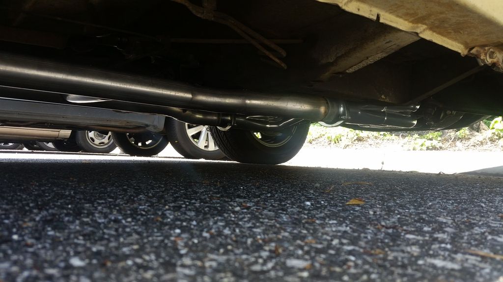

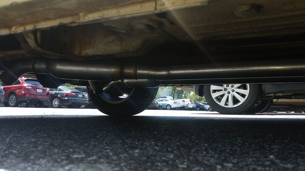

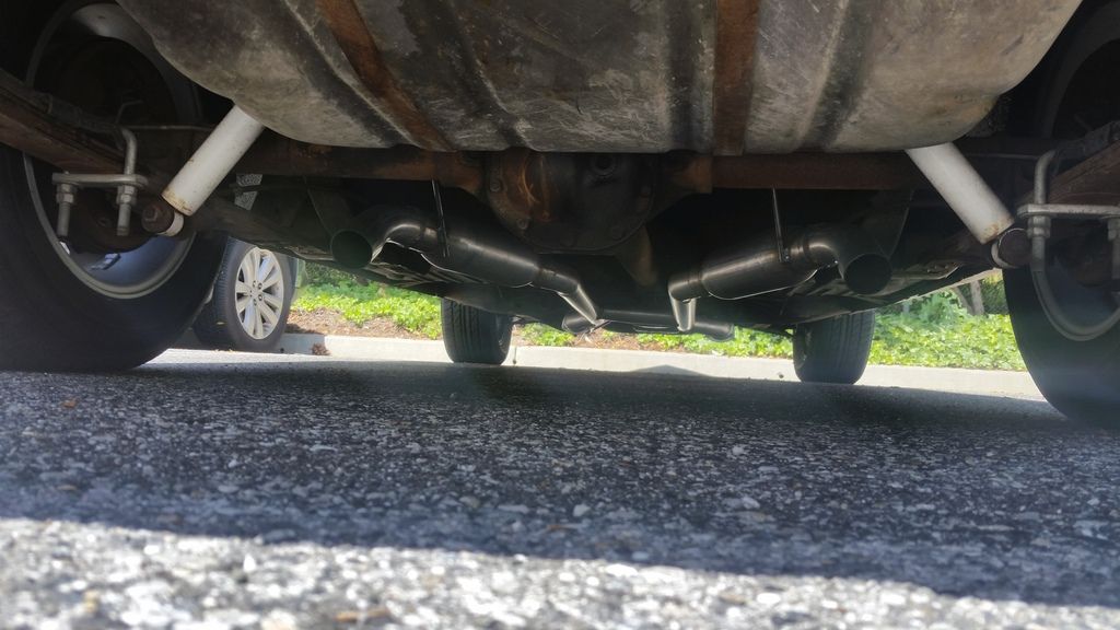

Tiny update, finally got around to have some friggin time to get the exhaust done (damn you rain and 9 to 5's!) ooooh how she sings now.. Loving the clearance, h-pipe, dynomax race bullets, turn downs.
Maybe I'll post a "sound test" video sometime this week . . .
