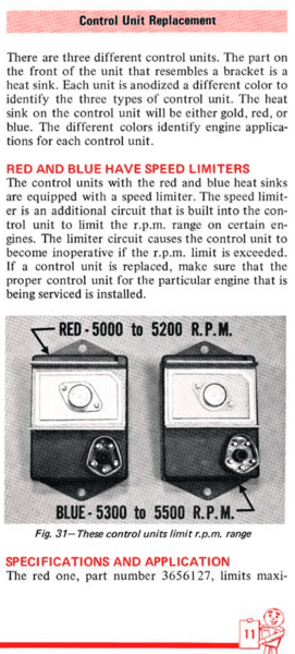

Looking at a few different parts sources, everyone seems to agree that the 74 Dart 225 was a 4 pin module but the one I have is definitely a 5 pin which is listed as a 75-76.
You now know "everyone" is wrong. The way to know this is to go to the original information.
The solid state ignition was introduced in the 1971 and 1972 model years.
There is a 1972 Master Tech Service Conference explaining the new system.
There is 1971 TSB covering the running implementation for 340 equiped cars.

1972
Engine Speed Limited
Where all the factory Chrysler part # ECUs Engine Speed Limited ?
Was always curious on those RPM limitations that we all seem to talk about
4111850 when they went to a 4 - Pin to replace or superceded everything previous and RPMs
1972
Only two ECUs in the 1972 model year as shown in the table were intentionally speed limited.
The red heat sink unit, part number 3656127 limits RPM to 5000-5200 and was used on 400 and 440 high performance manual transmission applications.
The blue heat sink unit, part number 3656128 limits RPM to 5300-5500 and was used on 340 manual transmission applications.
The intentional limits were dropped in 1973. However, all ECUs are limited based on the electronic component parameters used, similar to point ignition contact points float or bounce limitations when the RPM exceeds those parameters.
Chrysler generally, and potentially conservatively in some cases, rated other production ECUs, including 4111850, as good to 5500 RPM or 6000 RPM depending on the coil and ballast resistor used, as well as the application itself.
