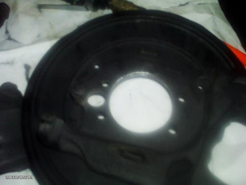

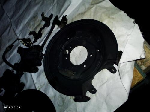

Hey all just received the hard parts from a 98 grand Cherokee rear disk brakes. Dana 35. Super easy to adapt to a 8 1/4 you just have to enlarge the axel tube hole and have 15" rims. The e brake is by your own design. Will post pics when I can figure out the ne computer. Good guy to get the parts from on ebay http://www.ebay.com/usr/stellablue420gratefuldead?_trksid=p2059210.m2749.l2754
Any questions just ask.
Yep cheap easy disc brake upgrade for the 8.25, why more people don't do it is beyond me.
It took me a while to believe it! Did the research and could not find anything but "it can be modified to fit" Just have to do the thinking on the e brake, have a few ideas.

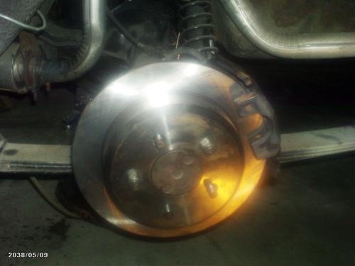

All that really needs to be done is enlarge the axel tube hole about a 1/16" and it fits right on. I will have to go to 15" rims my 14's are just a touch to small. I am actually looking at jeep mags that I can find 4 for 100! But also like the idea of steel wheels with moons on them. Or ideally painted hubcaps like the 14" ones I have to keep the old man look going. I will take more pics when I do the lines and e brake.

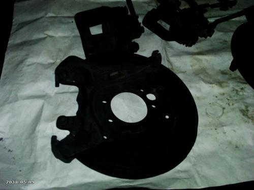

Yes the caliper bracket and the dust shield are riveted together.
The bolt pattern is 5X4.5 for the stock rotors. So far I have under 300 into it.
130 for the brackets and calipers
65 for pads, ebrake shoes and rotors
65 for new hoses and e brake cables from rock auto.

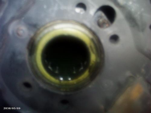

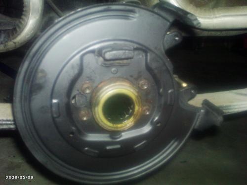

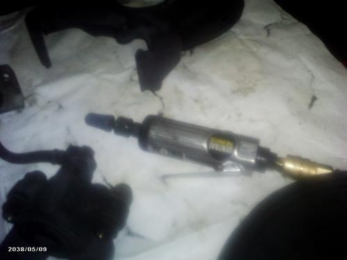

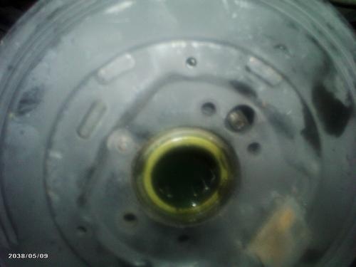

I'm doing the same swap on my 73 8.25 axle. I'll be using the 94-98 Grand Cherokee rear disc brake caliper adapter and dust shield out of a Jeep 8.25. These too have to be enlarged in the center hole to fit the A Body 8.25. I've bought brand new axle bearings and seals plus the carrier /pinion bearings and seals as well as calipers, rotors, hoses, the emergency brake shoes and mounting kit. I've got as far as enlarging the caliper adapters and dust shield (did them as a unit by bolting them together. Pics to follow.

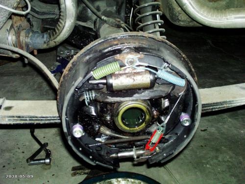

I thought 8.25 and 8.75 (and Dana) all used the same backing plates.
I think you are showing us which hole needs to be enlarged, but I'm not seeing it.
...I see now, the hole in the center of the backing plate.
