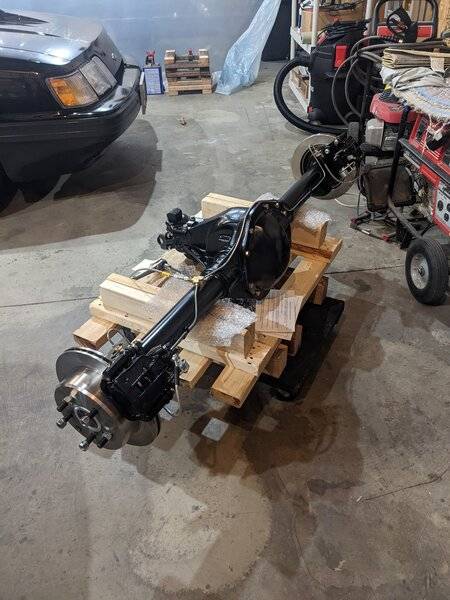

I see thank you so much for the help yall seriously learned alot. I think it did come with rubber lines but i had the ss ones. Also I contacted ss tube and they said I could send these back and get them cut to size with no charge. So I will have to know exactly where im going to put them. Does anyone have pictures of there setup with disc so I could get a idea of how it supposed to look and where to weld the tabs?
I see thank you so much for the help yall seriously learned alot. I think it did come with rubber lines but i had the ss ones. Also I contacted ss tube and they said I could send these back and get them cut to size with no charge. So I will have to know exactly where im going to put them. Does anyone have pictures of there setup with disc so I could get an idea of how it supposed to look and where to weld the tabs?

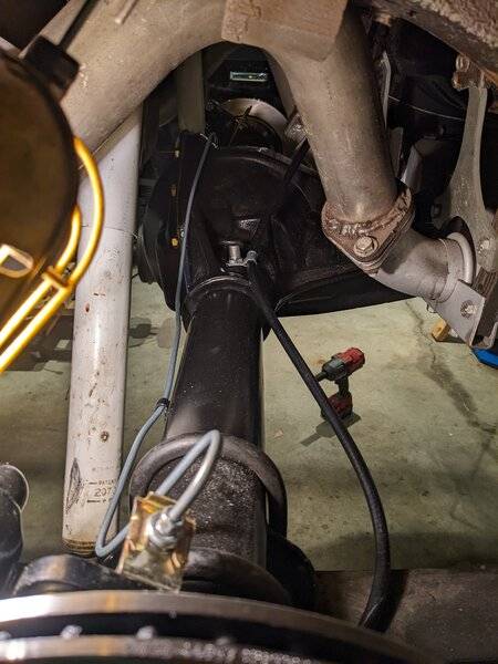

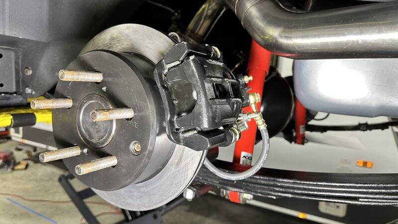

This is about the best photo I can provide at the moment, still unsure what kit you are using but mine is by Dr Diff and the brake line tabs are bolt on with this setup. As mentioned by others it would still be a good idea to contact the manufacturer of your brake kit to obtain some further guidance / instructions.
There is bracket that hard line routes to where it screws into a flex hose. Then flex hose hooks to the caliper
Yea im gonna get a flare ans shorten them. It's just a random a body speedway kit. It can with cubes but im just gonna welt the tabs on the rearend and have them connect to calipers to hardline since I have them like how 340s looks thanks everyone for your help
