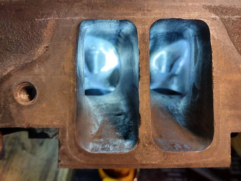

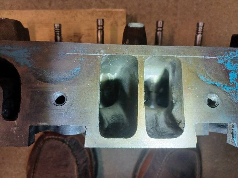

Here are some intake airflows from our flowbench. These are generalities and flow from different ports on the same head will be different. Also sometimes the 452 will flow a little better than the 906 and sometimes the other way around as in this case.
Lift..........906.........452
.100.......66 cfm...61 cfm
.200........130.........130
.300........189.........188
.400........222.........213
.500........234.........227
.600........237.........230
Do a valve job only on the heads and you would probably not be able to tell the difference in the power they would make.
Ah. ok. In terms of as-cast as Jim's info shows - they are pretty much the same. Personally I prefer porting the 346/452s but to each their own. Any head can be tweaked by a high quality performance valve job and if it was me I'd put exhaust seats and larger valves in it regardless. So the intake seats would be re-cut anyway. I don't think you can go wrong either way.
