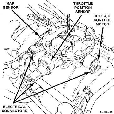

Idle Air Control valve? I know there are 3 or 4 different sensors on the throttle plate. Would this also cause my current condition or is that just the tip of the ice burg?

yes it could be something else but but most of time that's it take it out and clean it see if helps
this diagram shows where the iac is located on your particular motor. It takes two small allen wrenches to get it off. When you take it off, it will probably be black and covered with crap so just spray it will brake cleaner. DO NOT DO NOT attempt to push the plunger in/out by hand as that will ruin it and render it trash. Just spray several times with cleaner, let thoroughly dry. (might want to clean your whole TB while your at it, i'll bet it looks pretty bad too). Good luck!
