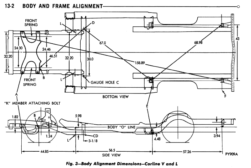

I CNC cut and bent my own spring mounts so i just want to make sure i install them properly but im getting mixed reviews on my research. I downloaded the 1973 body service manual to try and see what frame measurements tell me but it all seems to lend to welding it centered on the frame rail.... any input?
Frame measurement excerpt:
Will this cause the leaf spring to be non-parallel with the frame rail or perpendicular to the axle? or does it really matter?

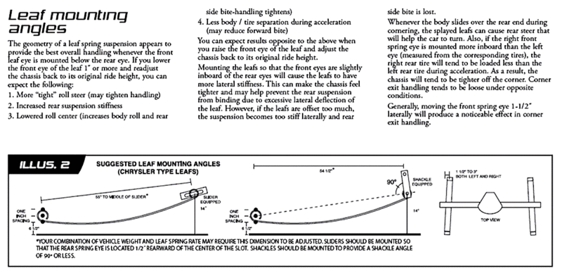

All Mopar E bodies, 73-79 B bodies, and F/J/M bodies all have springs with splayed mounting layout. E bodies are narrower in front mounting, the other are all narrower in the rear.
This type of layout provides increased roll resistance and reduced roll steer compared to a parallel layout.
So no, there is nothing wrong with this configuration. However, the minor amount there may be in a 3" spring relocation in an A body (no matter where you center the new bracket in the frame rails) is probably not enough to even notice.
And like all things suspension, there are both advantages and disadvantages to having the leaf springs splayed out.
This is the AFCO information with their leaf spring sliders, although it also cover quite a bit of leaf spring geometry and addresses the splayed spring geometry
"Mounting the leafs so that the front eyes are slightly inboard of the rear eyes will cause the leafs to have more lateral stiffness. This can make the chassis feel tighter and may help prevent the rear suspension from binding due to excessive lateral deflection of the leaf. However, if the leafs are offset too much, the suspension becomes too stiff laterally and rear side bite is lost. Whenever the body slides over the rear end during cornering, the splayed leafs can cause rear steer that will help the car to turn. Also, if the right front spring eye is mounted more inboard than the left eye (measured from the corresponding tires), the right rear tire will tend to be loaded less than the left rear tire during acceleration. As a result, the chassis will tend to be tighter off the corner. Corner exit handling tends to be loose under opposite. Generally, moving the front spring eye 1-1/2" laterally will produce a noticeable effect in corner exit handling"
