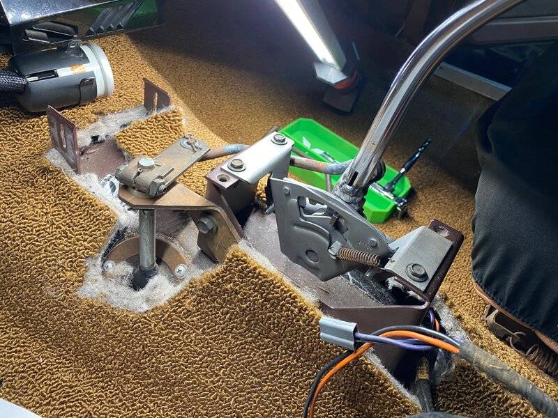

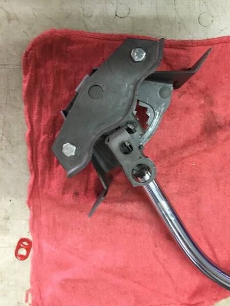

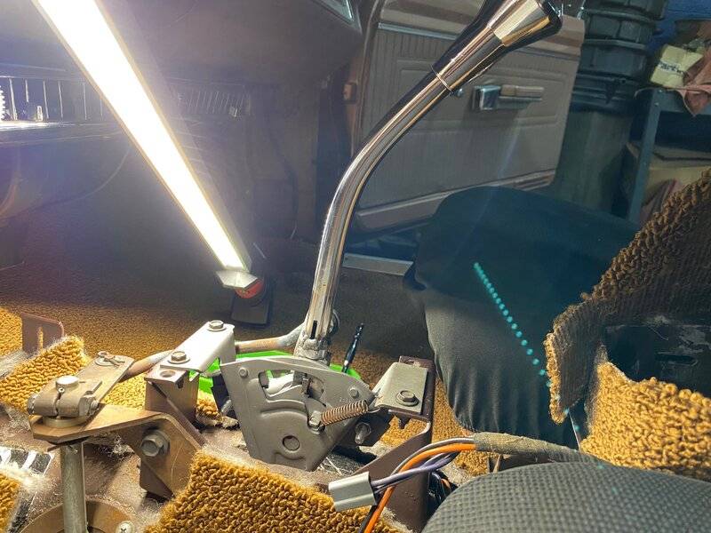

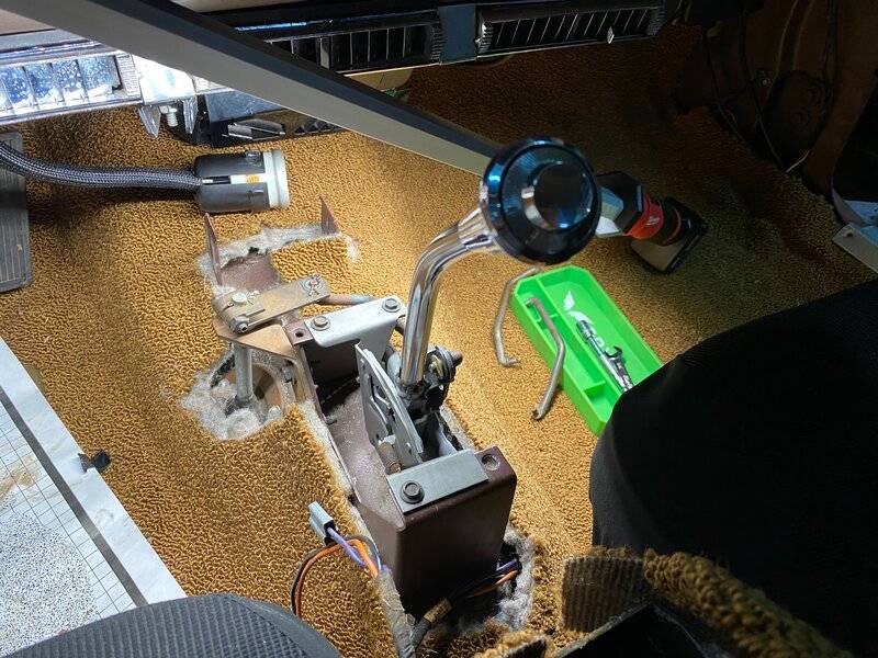

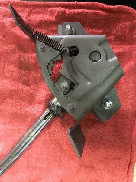

It took a while but I finally got the A body shift handle to work on a E body slap stick shifter assembly.
It takes modifying the pivot point for the E body shift and adapting the shifter cable from the A body shifter and making a new metal shift rod to fit the E body shifter assembly.
It also takes modifying the shift rod from the stock A body shifter making it line up with the modified E body shift point.
The only thing left is to go to the track and try it out.

It works great. I don't have time to do the mods myself right now. This took me 30-40 hours to get it working right. I will have to see what pictures my son has since I did it for his car and he took all the pictures.
What I can tell you is you will need a working E-body shifter assembly with the round handle. And a handle, shift cable for inside the handle, the shift knob with the metal button which works better than the plastic button, you also need the spring for the A body shift knob.
There is a lot of trial and error on making a new lower rod for the slap stick part. you need the original rod out of the E-body shifter to use as a pattern for the bottom of it. I used a piece of spring steel to make the new rod and threaded it so it could threaded into the metal piece on the bottom A-body shift cable.
This post could take me hours to right everything up. If you want to know it would be easier just to give me a call some time. I would be happy to try an explain it. Anyone interested PM me and we can set it up. In the mean time I talk to my son and see what pictures he has. I'm happy to help anyone interested.
