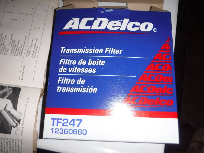

Hope this isn't anything to be worried about, but thought it was strange...Bought an AC Delco filter/gasket set,(FYI: paid more for it, (little US Flag), but ended up "made in china" anyway ), (from rock auto),

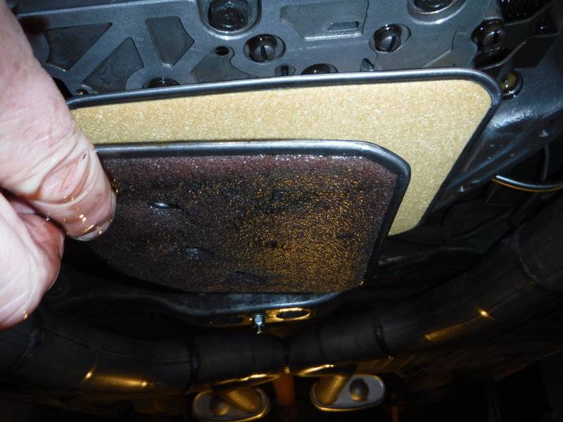

-The filter was quite a bit larger than the one I removed. it had one hole,(for fluid) on under side.
*the one i removed had two holes(one a little larger than the other)

What do you think about that filter? it bolted up fine, and the gasket(s) are 727 and 904,(got both) Think it's made for the next gen. trans with the overdrive? (forgot what # they are...518's i think), I can't imagine it causing an issue, but i'm no engineer. I'm thinking larger filter surface might be a good thing.
Your replacement filter is the proper one.
The stone-old dirty 'thing' that came off it is the wrong one.
Running a 2-hole filter on a '65 or newer transmission means the trans has been drinking partially unfiltered oil through the 2nd hole (although it is clamped against the valvebody somewhat).
