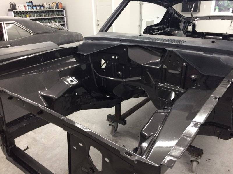

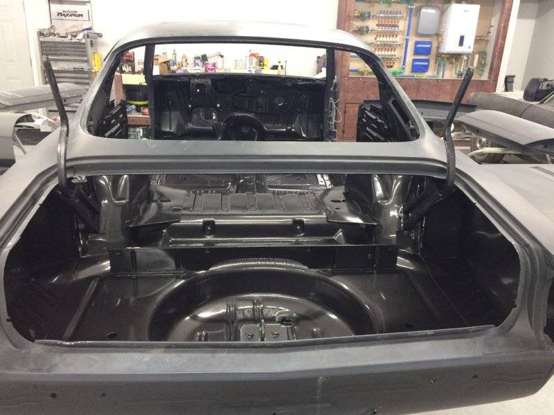

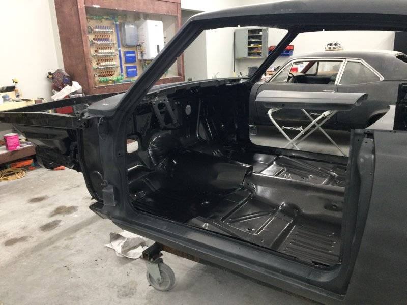

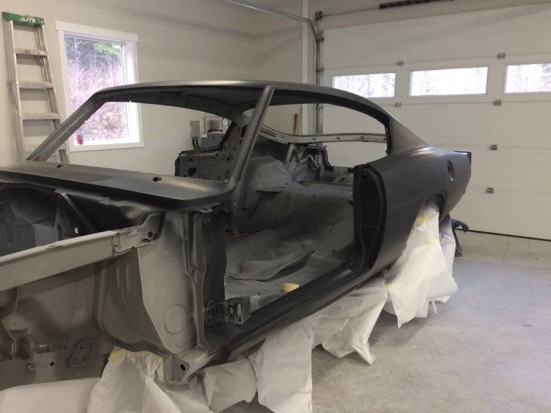

A few pics of barracuda project.
Also some pictures of the body of the car in black sealer.

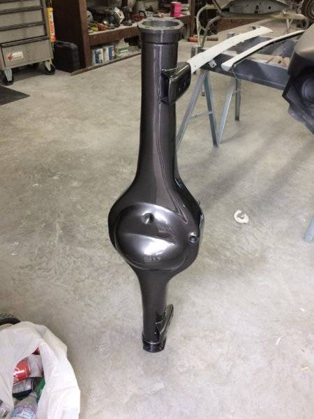

Paint the differential in the colour of the car. Turned out pretty good, but the pictures don’t show the true colour. It’s a little darker then in the photos.
That looks excellent!
Buford do you plan on racing this Barracuda at all? Tell you why I ask. I have a 64 Belvedere that I bracket race. I flattened and curled my perches, they were not boxed. My 60's went away, the car was porpoising, leapfrog launches, bust a ujoint and yoke and screwed my beautiful aluminum driveshaft. Frustrating as hell to find too, lots of work to replace, reset pinion angle, etc.
If you plan on getting on it you may want to think about boxing those perches just in case.
Check the deformed perch.
Wish I would have knowing this before, I got to this stage. Yes I want to race it a little, mostly Street class. Do you have pictures of the perched boxed in?
I have a couple, not the best job, was a "between race days" repair. Check the pics.
Found the problem when doing a visible overall inspection, noticed some space at the front between the perch and leaf. Doesn't look like much but when you launch the housing rolls back, pinion angle goes bezerk.
You can see the small gusset that I had installed, this was on the front. 1/4" flat, cut to fit like a gusset, to keep the perch from collapsing. I did the front on the right side as well, just because the right side perch was flattened far worse than the left side.
What you see here is that I'm in the process of installing ladder bars. I decided to leave the spring perches on the housing in case I may go back to leafs at some point. I never hear of people going to leafs from ladders though..
You may be able to see the rear gussets in the pic below. The ends of the perch are wide open and that allows them to squash (on the back side). On my Camaro I have a metal strap that wraps over the axle tube down to each end of the perch.
Thanks for the pics, I might strip the paint off and do some welding. Would I have to put the diff in a jig when I weld it? Not sure if it will warp or not, durning the welding. Like your idea on this, and by the way you have a wicked ride there, nice too see.
No jig, nothing will move, easy upgrade. You could fab up a nice fitting gusset in there, your just keeping the rear of the perch from crushing. Just a paint touch up afterwards. And if your not running slicks you likely wouldn't have a problem anyways.

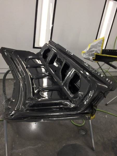

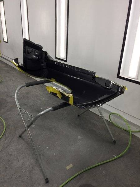

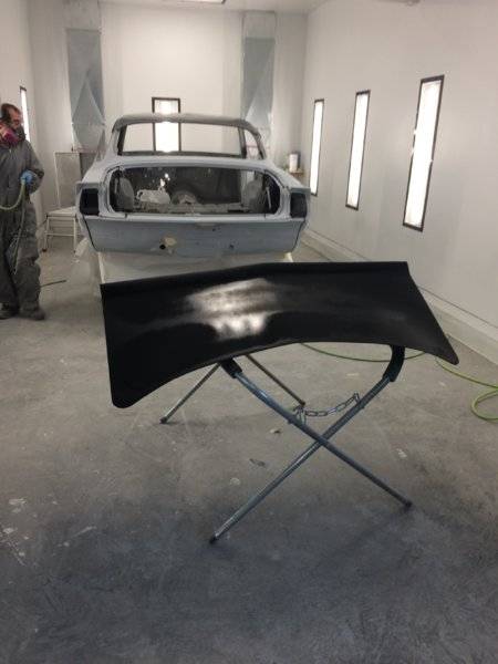

Car engine compartment,and interior sprayed in colour yesterday. Looks pretty good only complaint is some dust particles in the paint. Since I used a single stage, I can’t wet sand them out. Next will paint the inside of all other parts; doors, fenders and trunk. Hood will be paint in hot rod black colour.
Painted back side of doors,fenders, and trunk in there final colour. The pictures show lots of glare from the spray both lights, but they turned out nice.

Yes like you said before, it’s paying attention to the little details. Thats what make the car yours. When I seen the trunk after it was finished be painted, I seen a few blemishes in the paint. So I ask my painter what make this happen, he say sand from sandblasting. Paint gun must have distributed these grains, that were hiding some where. Then he say to me,I can repainted it if you want to sand them out. Four hour later the trunk is sanded again, and ready for paint. He also mentioned that no one will see it anyway, but I would alway know it there. Will post pictures later today of the trunk sanded again. Yes I can’t wait until the enjoy part arrives. Lol
Same thing (after hours of my prep work) with the single stage gloss black paint on the Flash inner areas. Almost like it was painted in a barn although I know better.
I hate single stage for that reason....no easy fix.
I re-sanded / scuffed everything but when re-painted, they went semi-gloss.
Yes I agree, single stage is not very forgiving. That’s why i will being using base clear for the rest of the project. Even when we reshoot the trunk I will paint base clear this time. Added a few more pics of sanded trunk and how some of the mods turned out in paint. Having problems loading photos will try later.
