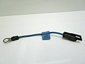

I am confused because the mechanic said he blew all the gauges. I tested power up to the fusible link and it was fine. IMHO I should have power to the car even if the gauges don’t work;correct? I am also wondering can you blow out individual gauges? The temperature gauge the needle is gone. I am having trouble finding the replacement cluster and the mechanic said that is where we have to start before finding out why there is no power.

There are three or four major points that you likely lost power........the wiring to and from the fuse link AND THE BULKHEAD CONNECTOR TERMINALS for the big red and big black wires, and possibly the WELDED SPLICE which is a few inches down the big lack wire starting from the ammeter black eyelet connections. Unwrap that harness a few inches until you find it, unwrap it and inspect. Also suspect the ammeter eyelet terminals themselves.
So next check at the bulkhead connector.
Then go inside and do the same.
The fusible link bulkhead terminal has a seal so its not easy to back probe.
You can remove the connector and check the terminal OR go inside and backprobe there.
I recommend checking the inside first. That will be faster and removing the bulkhead connectors is a little bit difficult. You can come back to doing that after reading up on some of the tips to removing.
