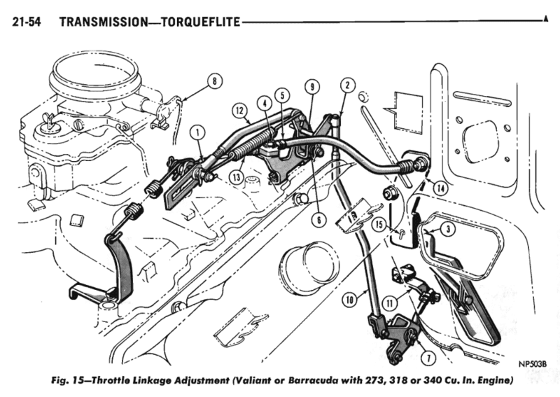

kickdown linkage
Is this what you are talking about? You crack me up with the photo suggestion, but I will post photos
Is reverse engagement also delayed; not just harsh? Did you check both sides of the dipstick and it shows full while running in neutral?
yes.

Good to hear. If you look at the illustration above, the slotted rod should just slide over the pin setting in the idle position. If it is under spring pressure you can unscrew it until it is in the right position. The shift mph can be fine tuned from there. That is a good place to start. I myself like a firm shift but the transmissions don't last long if it's the opposite and slides into gear at a low mph.

The car is running and still choked. What do you mean by the "pin setting"
According to that photo, yes the choke is still on and it's still on fast idle. Run the engine until the choke butterfly is open and rev the engine a bit to get it off fast idle. It should be at curb idle and not on the step of the fast idle cam. (the short adjusting screw) The long screw is the curb idle screw.
Yes it is on curb idle now. Where should the slotted rod be located when at curb idle?
The end of the slot should be at the pin to start with little or no drag. I would remove the return spring the clip and washer and try to slide the slotted arm off the pin. If it drags too much it's too tight and can cause firm or harsh upshifts. If it drags, slip it off and screw the end in and put it back on the pin. As I said, to start, the end of the slot should fit against the pin, no gap or tension. You can fine tune from there. Unscrewing the end will increase shift feel. Screwing it in will soften the shift. Only a turn or 2 at a time then test drive to see how it is.
I bet you can't open the carb all the way by hand, and you won't be able to push that slotted rod back any further. Take the slotted rod off the pin and turn it clockwise; shortening it; until you can open the carb all the way with the slotted rod installed.
This is without the return spring. So it is to loose and I need to get the right side (back) of the slotted arm just to the pin?
Try unscrewing it to close the gap. When the throttle is wide open, the linkage should be at it's furthest position. You would need to jack the car up with stands underneath and have a helper to test it that way.
Took it for a test drive and I like it shifting at a higher speed however, it is still shifting hard into 2nd.
