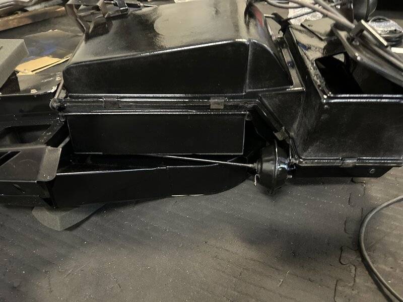

I'm in the process of rebuilding the factory Ac/Heater box in my 1967 Barracuda. I was almost done when I noticed that the interior door and lever on the exterior of the box that bolts to the door which the lower vacuum servo operates, is missing.
Any ideas on where I could get something like this? I guess I could try and fabricate one if all else fails, but wondering if anyone had any ideas who might have these parts? Obviously nothing on Ebay, and no one is going to make such a one off part.
Here are some picks of the what I'm talking about. As well as a pick of what one with the door and lever in place?

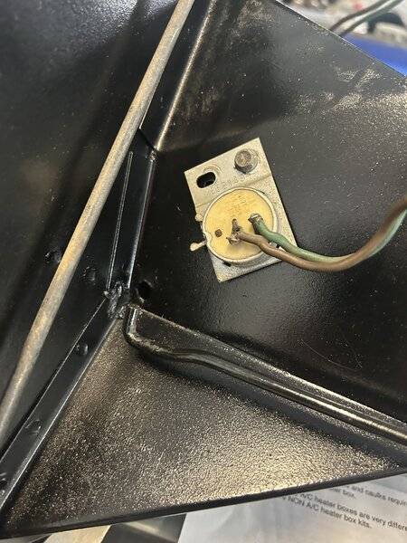

Oh, and that AC, heater blower switch. Where exactly does that go? I've searched all over the AC box and the only two holes that match up is where I have it in that picture, but don't know what would hit that switch there unless the lever on the missing box activates it somehow?
I think you are correct. I can get a photo if no one else comes through. It on a top shelf in the garage.
I believe Dana is correct. That "switch" i think goes closer to lower drivers side. I could be wrong tho. I belive it acts like a "thermostat"??

Yep, that is the one. But mine is definitely gone. The box has not been taken apart.
In the ‘67, it looks like there are two holes for the rod that holds it in place. I guess it can be removed without tearing the actual box apart by pushing the door up on one side, then pulling one side of the rod out of one of the holes?
I might have to try and fabricate something up? Another trick will be getting a lever, the part that bolts door on the outside that the vacuum actuator connect to.

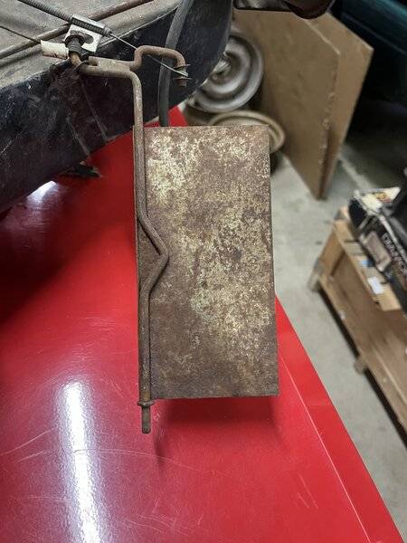

Here is a picture of my box when I took it out of my '69 a year or so back to rebuild it. The door has little clearance side-to-side. When I had mine apart I wanted to take that door out because foam must be glued to each side of that door. Plus I wanted to paint that door. However there was no way it would come out without either bending housing OR breaking the welds between the door and the rod. It appears the rod was put into housing then the door was welded to the rod.

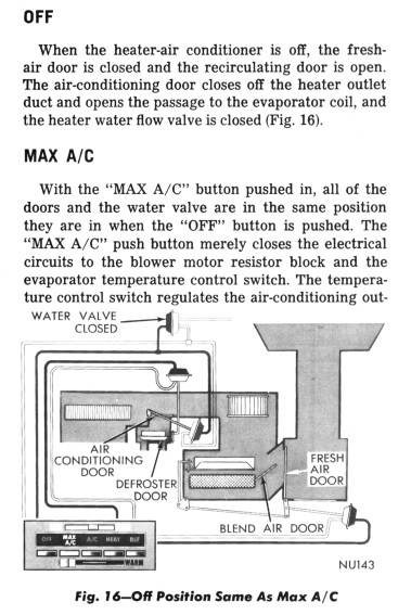

The Factory Service Manual refers to it as an "Air Conditioning Door"
That’s definitely the door that’s missing. Not sure how they got it out, but the rest of the box looks untouched as far as the welds. Maybe they cut the end of the rod off or something then pulled it out?
The big question now is how do I get it working properly again? I guess I have to try and fabricate something, which would include the lever on the outside. Try to find another housing that still has the door intact, or go aftermarket?
