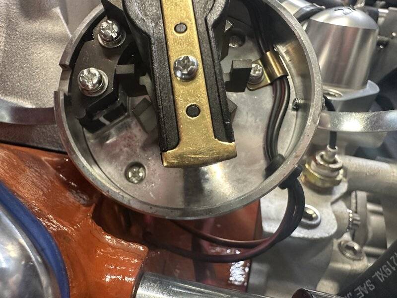

Bought a 440 Source distributor and need to reduce the curve from 25. Did not come with paperwork and haven’t heard back from 440 Source in weeks. Can anyone point me in the right direction to change the curve?

Without seeing the actual mechanism I can't say for sure but some of those cheap(er) distributors were never intended to be changed.
Can you take a picture of the mechanism? Or a drawing if you can find one?
Edit: 440 Source says it is adjustable. It still depends on what type of advance mechanism they used as to what you need for springs and weights but evidently it was designed to be adjustable.
That Distributor appears NOT to have a VA on it,
making it NOT street friendly, and especially not hi-way friendly if that matters to you. But it works well enough with a higher stall convertor.
Personally, I am a big fan of VA and run 22* in mine.

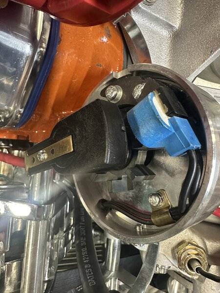

Thanks for the reply. Below are the pictures.
Actually does matter quite a bit. I bought this as the quickest easiest cheapest way to get this motor running before winter.
I used one for 5 1/2 years 15,000 miles and about 110 passes, I took it apart changed the spring to a light one and bent the tabs until I had the advance where I wanted it still have it sitting on the shelf.
