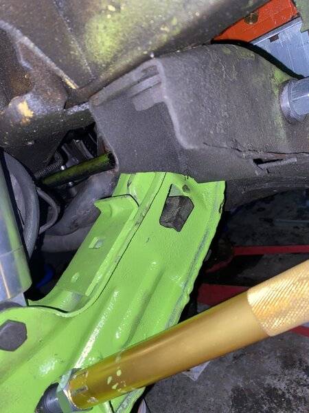

Does the torsion bar key look like it’s in the right position with the LCA fully relaxed? The adjuster bolt is just touching. The adjuster bolt seems to be sticking out quite a bit more than when I took things apart, but maybe I’m just paranoid I screwed something up.
