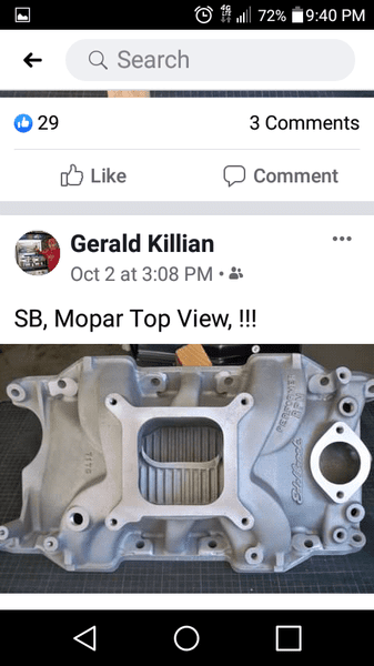

              After modications !
              Porting and converted to W2 bolt pattern.
