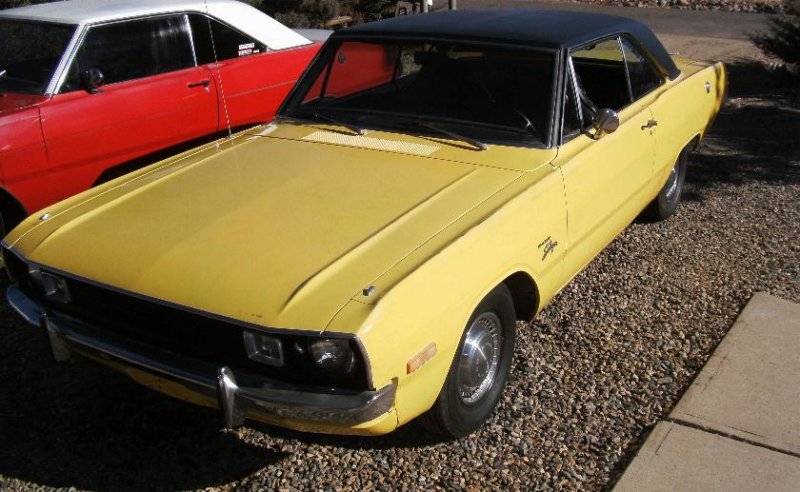

Advice on buying a '75 dart.
I have to say that I like the seats. Probably way more comfortable than the orange crates that came stock.
