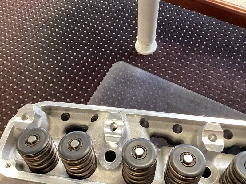

AFR Blue Hornet Mopar cylinder head, Charles Servedio
Although they don’t specify it one way or the other for this head on their website, AFR usually tests the ex ports with a flow tube in place, which would explain part of the discrepancy in flow numbers on that side of the head.

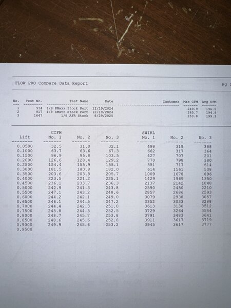

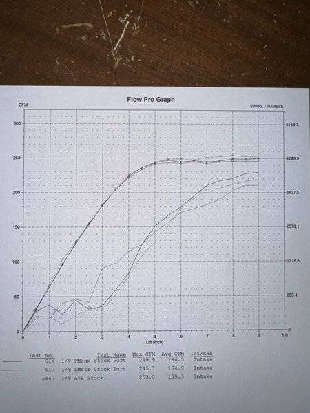

Doing this from my phone so don’t know what the resolution will be. Here’s the AFR vs SM vs ProMaxx on my bench. AFR is slightly better than ProMaxx. ProMaxx is slightly better than SM.

Did you use a backcut valve?
The promaxx and AFR both show about 191cfm at .300” lift ok their websites.
I thought the speedmaster would be further down than this. Seems like pretty much a wash.
With a typical street build should be able to get 1.5-1.8 hp per cfm, so about 375-450 hp, crank up the cr and cam 2+ (500hp) shouldn't be impossible with any of these heads question becomes why buy AFR's and Edelbrock's and not go for TF's and more power or same with smaller cam ? SM has enough price difference to still be an option.

AFR was tested with the AFR valve which is back cut. The ProMaxx and SM were tested with a SM valve which was also back cut.
Don’t think I have ever had a head test as well as advertised on my bench. Maybe 1 port on a TF head, but then the port right beside it may be down significantly.
