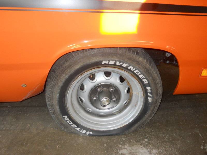

The bolt that the insurance took with them must have been missing some. I don't remember the threads being that much longer. I never found the nut or the washers. But the rest of the bolt was laying on the rail behind the shock. They could be laying at Nuemedia dragway.
What I believe was causing the front wheel shake when the wheels lifted was the pins bouncing out of the bushings.
There was so much pressure pushing back on the spindle out side of the strut rod fulcrum. When the wheels went up the pressure left go and the arms would bounce back pushing the torsion bars rearward against the clips. Now this is my theory I never put a Go-pro under the car. But what else could it have been. Also when the arm bounced back it toed the car in alot and can be seen on the video. 60' was consistant 150's

Not sure what brand but they were the style that had two flats instead of one flat on the bolt. this give a lot less thread area. I Had more of them in the parts bin I threw them all away. I think I bought them at NAPA. I should have used cleaned up original bolts with one flat. The poly bushing just came apart from foot braking it. They are stiff but they are junk. I will never use anything for bushings but rubber
I knew they were bad and we were about to pull it in the shop for a new K-member we built with Heim joints on the struts and 73 steering. . (pictured below) My son took it for one last ride. little did we know
