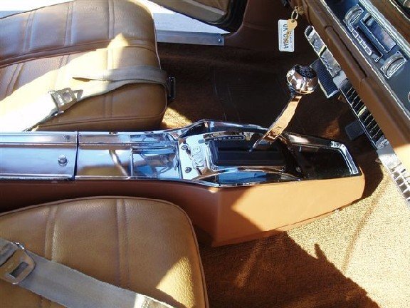

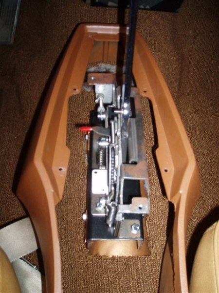

I had trouble with the cables getting melted near the last bend (near the shift linkage). Looks like this guy had the best idea.
